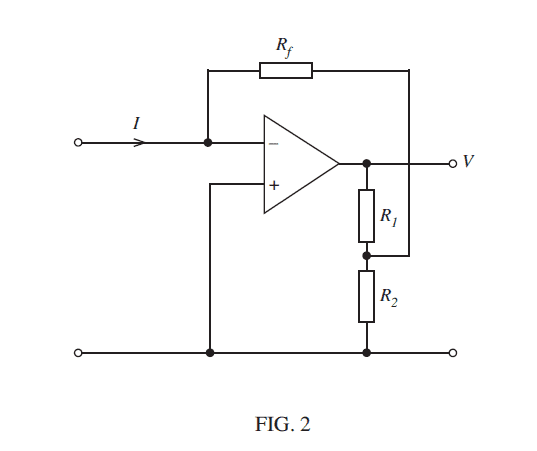

The circuit of FIGURE 2 is known as a transimpedance circuit used
for the measurement of very small currents. Derive the relationship
between the output voltage V and the input current I; i.e. if V = kI
find k in terms of R1, R2 and Rf.

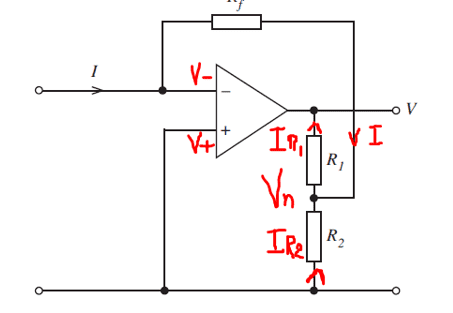

If current flows from left of Rf to right and V- is 0V then I is negative.
Then Vn (which is the voltage drop over Rf) = -IRfR2 and Rf in parallel have the resistance
R2Rf / (R2 + Rf)We now have a voltage divider:
Vn = {[(R2Rf / (R2 + Rf))] / [ R1 + R2Rf / (R2 + Rf)]} * Vout
Vn = R2Rf / (R1(R2+Rf) + R2Rf) * V
Vn =-IRf
I = -Vn/Rf
I = -[ R2Rf / (R1(R2+Rf) + R2Rf) * V ] / Rf
I = -R2V / (R1(R2+Rf) + R2Rf)
I * (R1(R2+Rf) + R2Rf) = -R2V
V = -[ I * (R1(R2+Rf) + R2Rf) ] / R2V = kI
V / I =k
V / I = -(R1(R2+Rf) + R2Rf) / R2
k = -(R1(R2+Rf) + R2Rf) / R2

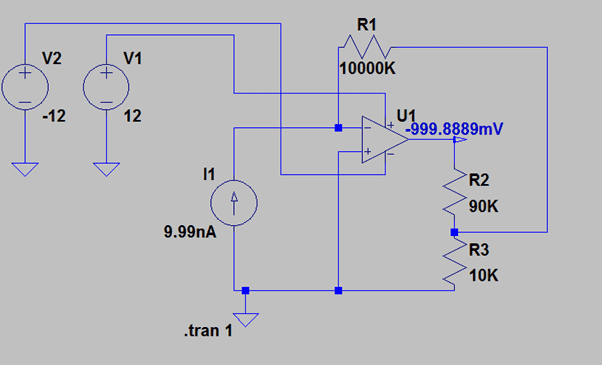

I use these values and plug them into a SPICE program and see that somewhere I am out by a factor of 10.
I just can't find my mistake
If anyone can help I would be much obliged.
Thanks
Hi WeeChumlee, Welcome to Physics Forums.
I think you want to check the size of your current source. What was your calculated value (in Amps)?
Calculated current was 9.998nA. (So 10nA)
This though should be 1nA . with 1nA the simulation works.
Somewhere is a factor 10 mistake I presume but I son,t see it.

Can you show the details of your calculation? Let's try to spot the missing 10 :smile:
Here is my recommendation (for a much shorter calculation):
If you place the resistor Rf very close to the common node of R1 and R2 you will see that these three resistors form a star network.
Hence, applying the star-triangle transformation the feedback circuit will be simplified because one of the new resistors is between opamp output and ground.
Hence, this resistor has no influence on feedback - and the remaining circuit looks very convenient (only two feedback resistors).
Yes that works. Another shortcut is to realize that the input current fixes the potential at the resistor junction node. Just write the node equation (KCL) and substitute the fixed potential for the node voltage. The only variables left are the current and the output voltage.
The OP did derive a correct expression for the proportionality constant, so I think the remaining issue will be related to the units used (nA versus pA for example...). I'd like to see the OP's actual calculation for k and subsequent calculation of the current for the given -0.1 V output.
