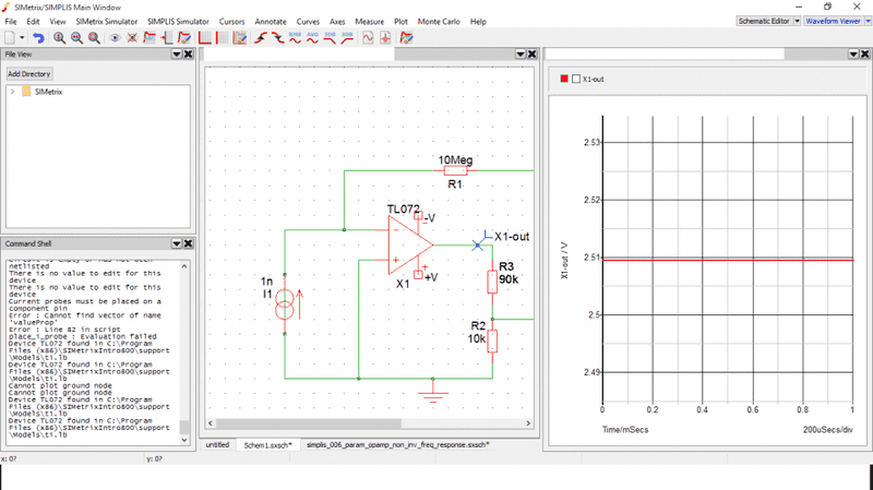

(c)
Im not sure how to complete this schematic, I need to check current calculation in (b). I don't kow what "Vin" is. Any help is greatly appreciated as I have no training on this software.

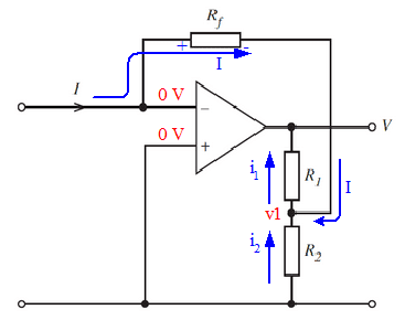

Instead, try KCL node analysis at the junction of R1 and R2, and note that the voltage there is fixed by the potential drop across Rf (v1 in the image below).
KCL node analysis at the junction of R1 and R2, I have (V1-Vout)/R1 for I1 and for I2 I have (Vout-V1)/R2.

Well according to KCL, I1+I2=I so V1/R1-V1/R2= I
Nope and nope.
Both I and i2 are shown flowing into the node, while only i1 flows out. So i1 = i2 + I. That means i1 - i2 = I. Also, R1 and R2 terminate at different nodes at different potentials (R1 terminates at the output node that has potential V), so you can't write V1/R1 - V1/R2 = I. You need to write the node equation that takes into account the nodes where the branches terminate.
If R1 terminates at the output node then that's Vout/R1 and R2 terminates at the central node so that's -V1/R2, and for Rf is V1/Rf. Since I1=I+I2 then Vout/R1=-V1/R2+V1/Rf.
No, in nodal analysis you write the current on a branch between two nodes as the potential difference between the nodes divided by the branch resistance. So for example if there was a resistance R between a node at potential Va and another node at potential Vb, then the current flowing from node A to node B through resistance R would be given by (Va - Vb)/R.

R2 connects between v1 and ground (0V), not Vout. You already know the current coming from the Vin node as ##I##, so you don't need to know Vin. Nodal analysis uses a sum of current terms (it's KCL at a node), and ##I## is the known current in that particular branch.
If I have- (V1-Vout)/R1+(0-V1)/R2 =0 for my nodal equation, where does Rf come in? As I need to find K in terms of all 3 resistors.

There are three branches meeting at node v1. You need three currents... which one's missing in your equation?
Well its "I" flowing through Rf, Which is V1/Rf, So the three currents therefore are (V1-Vout)/R1+(0-V1)/R2 + V1/Rf =0
True, but look at the diagram I posted in post #4. That current is a given quantity (well, a given symbolic quantity anyways).
Are we talking about representing V1/Rf as simply "I" in our nodal equation? If so how is Rf represented for my derivation of K? Thanks for your patience.

Yes, you need both an "I" and and "Rf" eventually. Since "I" is a given you can use it as though it were a constant. So plugging it into the node equation you have (summing currents leaving the node):
##\frac{v1 - 0}{R_2} + \frac{v1 - Vout}{R_1} - I = 0##
Now since ##I## is a given quantity you can find a value for v1 separately. Just follow the path from the input to the v1 node. What potential drop can you see?

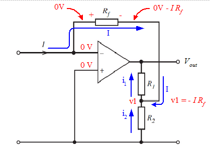

Right. So write the corresponding expression for v1. v1 = ?
Well V1=I*Rf. So the nodal equation is (V1-Vout)/R1+(V1-0)/R2-(I*Rf)

Ah, no and no :frown:
What's the direction of the potential drop from the input across the resistor Rf? Is it a positive or negative change in potential? In other words, will the change cause v1 to be positive (above the potential at the input) or negative (below the potential at the input)?
For the node equation, don't substitute a voltage for a current! I*Rf would be a voltage. Leave the ##I## alone! It's a given value, so don't complicate it. What you really want to do is get rid of the v1 in the node expression. That's why we're looking at finding v1 via the current ##I## and the drop across Rf.
The p.d has a negative potentional, not too sure how to remove V1. In terms of (V1-Vout)/R1+(V1-0)/R2= 0, I get Vout=V1((R1/R2)+1). If its a negative p.d, does V1 in that equation become Vout= -I*Rf(R1/R2+1)
You left out the ##I## current in the node equation; There are three terms as I wrote in post #19.
To remove V1 from the node equation you find it a different way and use that to replace it. That's why you want to find the potential V1 using the current ##I## and the resistance ##R_f##.

First of all, you seem to be stuck on getting the sign right for the relationship between ##I## and V1. I flows from left to right through ##R_f## causing a drop in potential. The left end of ##R_f## is at zero potential thanks to the input of the opamp being held at zero potential. That means V1 must be: ##V1 = - I R_f##. Note the negative sign!
Second, you end up with a single equation containing both ##I## and ##V_{out}##. Isn't that ideal? Just rearrange it to solve for ##V_{out}## in terms of ##I##, or vice versa.
Ok, (-I*Rf-Vout)/R1+(-I*Rf-0)/R2-I= 0 transposes as Vout=-I*Rf(R1/R2+1) to which I= 1nA.

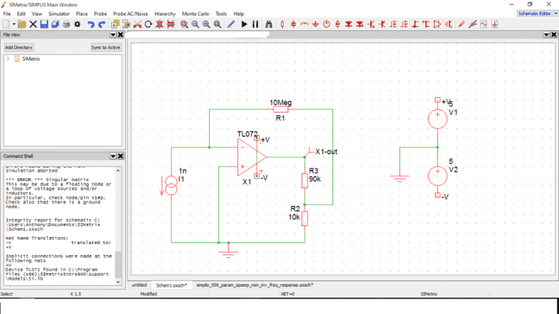

To get the Simetrix schematic I am having trouble running a simulation as I keep getting errors (as seen in the command shell) and I have no idea, as a novice, how to rectify it. I need to probe "Vout" using the current generator featuring current 1n amps.
Presumably you've made a simplification based on a justified numerical approximation along the way?

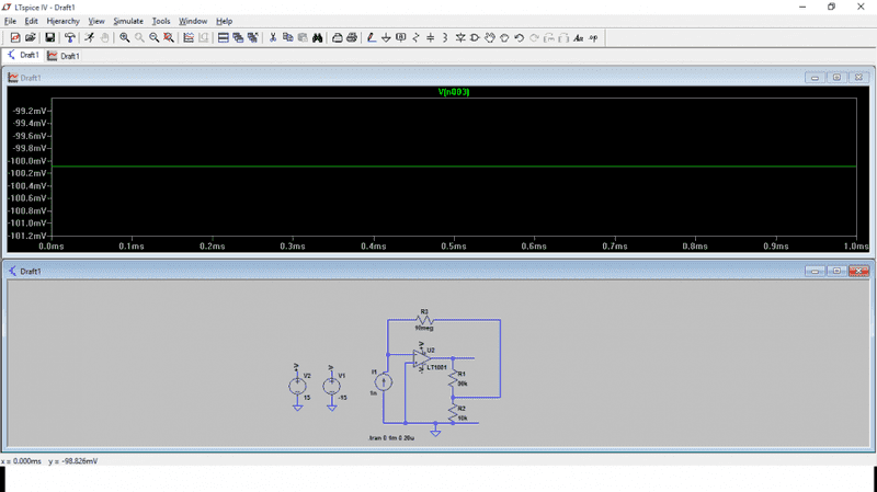

I'm not familiar with that simulation software. Looking at your schematic, I think you should turn your current source around so that the current is injected into the input. Check the polarity of the power supply connections to the TL072.
Wel the simulation works however the voltage outcome is disappointing as you can see:
