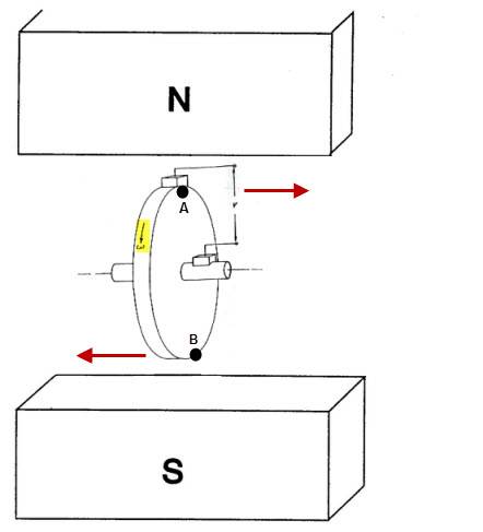

Hi,
Could you please help me with the queries below? Thank you.
Question 1:
Please have a look on this attachment. In the given attachment, the disk is mounted vertically and only a part of the disk passes thru the magnetic field at any instant. If entire surface of the disk was rotating in a uniform magnetic field then I don't think any eddy currents would be produced. Do you agree?
Question 2:
If the disk was instead mounted horizontally but still all of the disk rotating in a uniform magnetic field, would it result into production of any eddy currents?

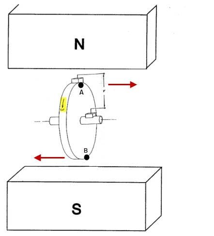

Please have a look on this attachment. If the attachment is not clear please have a look here. I believe that "v" represents the direction of disk rotation. How is the direction of "v" is being determined? The direction of magnetic field is from left to right and disk is rotating clockwise when seen from the left side.

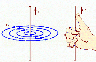

Diagram of a straight vertical wire carrying current I upward, with concentric blue circular magnetic field lines labelled B around it, and a right hand with thumb pointing up along the wire showing the right-hand rule.
We can see that there is circular magnetic field around wire but where are the north and south poles of this circular magnetic field?
Yes, but there will be a voltage between centre and rim of the disc.
Yes. Emf will be indued along the thickness of the disc.
PainterGuy said:
It is said that an accelerating charge radiates electromagnetic waves, does this mean that the quantity of charge would reduce as a result of emanating electromagnetic waves?
No.
It is the instantaneous linear velocity of a point on the circular disc (with a direction tangential to the circle).
There cannot be a single isolated current carrying conductor, there's always at least one more conductor that acts as a return path for the current. Together they two form a single-turn coil which acts as a bar magnet and you can find its polarity.
It is not a dipole field so it doesn't have a well defined pole.

Using right hand rule, it shows the direction of induced current at points A and B, and it looks like that lower and upper halves of the disk will have different charge distribution.
Diagram of a copper disk between an N pole magnet above and an S pole magnet below, with points A and B marked on the rim, a yellow highlight on the disk's left edge, and red arrows showing rotation direction.
@cnh1995 : Let's think of an infinite wire and in such a case we can ignore the return path.
@Dale: Yes, it does look like that it's not a dipole field but a magnet cannot exist as a uni-pole which also implies no magnetic field without a 'dipole' magnet.
Just because there are no magnetic monopoles does not imply that all magnetic fields are dipoles. There are many fields that are neither.

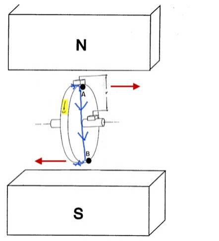

PainterGuy said:
So, you are saying that the eddy will be produced and an emf will be also induced. I had the construction below in mind.
You have joined the center and the rim. I was talking about the same configuration, but not with the center and rim connected together like that, just the rotating disc.
In that case, current will flow from A to B on the upper surface and from B to A on the lower surface.
Okay. But in the other configuration where the disc is horizontal, the center and rim were connected too so why is it different for this case when the disc is vertical as shown below?
Diagram of a vertical copper disc rotating between an N pole magnet above and an S pole magnet below, with brushes at points A and B on the rim and axle, red arrows showing rotation direction, and a yellow highlighted radial segment.

PainterGuy said:
If you say so, I'd agree with you. But could you please tell me of some fields which are neither monopole or dipole?
The field around a straight wire for one, and all of the multipole fields greater than dipole, and a plane wave.
That connection is necessary for a current to flow. Without that connection, there will only be voltage present between center and rim of the disc.
For the vertical disc in your diagram, no connection is required between center and rim as the current is flowing along the path I've shown in #6. If you connect the center and the rim, you are providing a parallel path for the current and some current will be diverted through that path.
