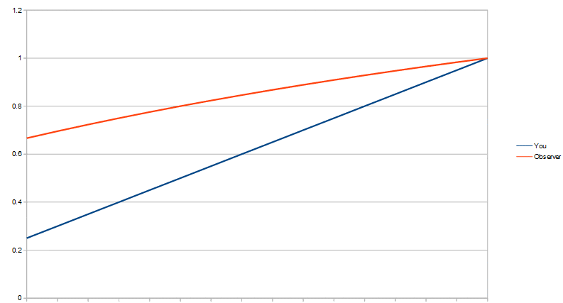

Both the baseball and and light behave by the same rule for the addition of velocity, the one already given by Nugatory.
If you throw a ball forward (relative to you) at 0.25c while traveling at .5c relative to someone else, you measure the balls speed as 0.25 and he will measure it as being 0.666.. c (not 0.75 c as you would expect using Newtonian velocity addition.)
If you throw the ball at .35c, the you get 0.35c and .7234c.
If we graph the results as you throw the ball faster, you get the following:
Line graph with x-axis unlabeled and y-axis from 0 to 1.2. Blue line labeled You rises linearly from about 0.25 to 1; red line labeled Observer starts near 0.67 and curves up to meet the blue line at 1.
The blue line is the velocity you measure for the ball and the red line the other observer's measurement of its velocity (you are moving at 0.5 relative to the observer. Note how your velocity measurement and that of the observer converge as you throw the ball at a speed closer and closer to c, until, at c they become the same. (you wouldn't really wouldn't be able to throw a massive object exactly at c, but you could get so close to it that the difference between the two velocity measurements is as close to zero as you want.)
So yes, it is the speed, (and the fact that light, being mass-less travels at it) that determines why light has the same velocity as measured by everyone.

Since cars and headlights can't travel very fast, let's use better examples. Say we put some radioactive ions into a particle accelerator and get ithem going at 99% the speed of light (0.99c). Then one of them decays and emits a neutrino. From the point of view of the other ions, that neutrino may be moving forward at over 0.9999c. So you might expect that the scientists would see that neutrino moving forward at 0.99c + 0.9999c. But they do not. They see it moving at close to the speed of light (over 0.9999c, but less than 1c).
AH HAAAAA! EUREKA! It IS the velocity that is the key! Thanks for the chart. That helped. As velocity increases toward the ultimate relativistic velocity the "observed velocity being the same in all frames of reference" principle becomes more pronounced until when we reach the ultimate velocity all observers in all frames of reference measure the same velocity. Conversely, as the speed reduces the greater the difference in observed speeds in different frames of reference...so much so that at tiny speeds (relative to light) the velocity is altogether additive or subtractive, or at least the math is simple addition or subtraction.
So if ANYTHING reaches the speed of light, even apples (if they could)...as they get faster and faster...and because of the velocity factor...different observer's measurements become closer to "the same velocity regardless of frame of reference" until eventually even apples will have the same max speed regardless of frame of reference. The issue then becomes simply...what can or cannot actually attain that speed due to its mass...apples can not. Photons can.
I think I've got it. The chart was the key. Thanks

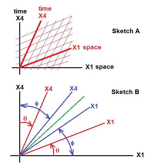

Two sketches of Minkowski spacetime axes. Sketch A: black time X4 and X1 space axes with red rotated axes and a red grid. Sketch B: red, blue and green X4 and X1 axes fanning out from the origin, with angles phi and theta marked.
Sketch A. The black coordinates observer is at rest in his black coordinate system and remains in position X1 = 0 as he moves straight forward into time along his X4 coordinate. The observer in the red coordinate system remains at rest in red position X1 while moving straight into time along his red X4 coordinate. We show here the red observer in motion at a significant percentage of light speed (perhaps around 0.5C) with respect to the “rest” black coordinates. The black observer sees the red observer moving along a continuous succession of points along the red X4 coordinate. Notice that, using Lorentz transformations, the red observers spatial X1 coordinate is rotated at an angle to the black X1 coordinate that is symmetric with respect to the rotation of the red X4 coordinate to the black X4 coordinate. This gives the red observer a different instantaneous 3-D cross-section view of the 4-D universe than that of the black observer. That is, the red observer sees a cross-section of the universe along his red X1 axis, whereas the rest black system observer sees instantaneous cross-sections of the universe along his black X1 axis.
Sketch B. Now we see the progression in the rotation of the X1 and X4 coordinates with respect to the black coordinates as observers move faster and faster. The blue observer moving along his own blue X4 coordinate is moving faster than the red observer, and blue’s X1 coordinate accordingly rotates to maintain the rotational symmetry.
So, what happens in the limit as an observer’s speed with respect to the black rest coordinates approaches the speed of light? In the limit the X4 coordinate and the X1 coordinate rotate toward each other, both reaching the 45 degree angle in the limit: The angle of a 4-dimensional photon. Thus, we have a geometrically unique orientation for any object moving at the speed of light. The green world line then represents a photon moving at the speed of light in all three coordinate systems. Note that as a result of the symmetric angles for the X1's and X4's in all coordinate systems, the ratio of the X1 to X4 for the photon line assures that all observers will find a ratio of 1:1 between X1 and X4.
