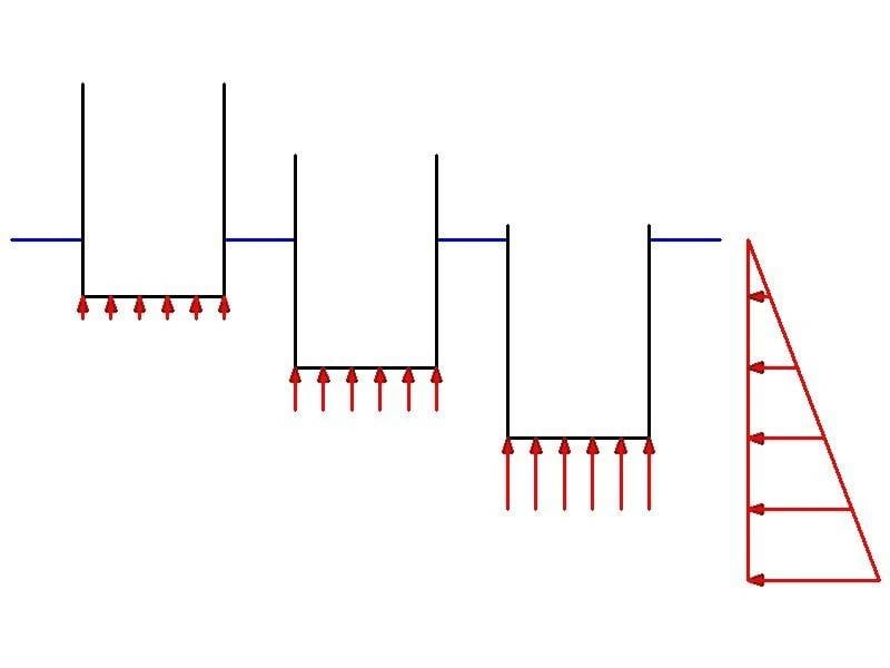

Be very clear here, please. Exactly which two scenarios are you comparing and claiming are the same?
The pressure in the water increases with depth in any case even if there is no boat present .
Think about a very simple boat consisting of a short vertical axis cylinder with a flat bottom . As this boat sinks further into the water the pressure on the bottom surface increases thus increasing the upward force on the boat .

I was struggling with why the water pressure beneath the bottom surface of the boat should increase with depth because the only thing that this body of water carries is the weight of the boat all the time. Even if the boat sinks further, any extra weight in the form of excess water is pushed to the sides by the boat so there's still a net weight of the boat that is being carried by the water beneath it.
It is as if you're decreasing the volume of the water beneath it (= the boat sinking further), but at the same time you're actually removing water from that volume (the boat pushes water away as it sinks) and thus the pressure beneath the boat would stay the same. Unless ofcourse the increased water height on the sides causes an increase in pressure on the water beneath it and in turn exerts a force against the body of water that is beneath the boat.
@Dale : I've made a simple drawing regarding this theory to explain what I mean (you need to zoom into see the text): https://www.dropbox.com/s/wtx6um71apt7kbe/Archimedes.jpg?dl=0
Could this theory be correct on why the buoyant force increases with depth?
In your drawings h is irrelevant and can be made to go to 0 simply by making the water container very wide.
Do you understand that, even without the boat, the water pressure increases with depth? The presence of the boat is not what drives this effect, just the weight of the water itself.
Do you know the formula for calculating the water pressure as a function of depth. (in the fluid itself without any boat)

The upthrusting force comes from the pressure only. There is no increase in pressure when the object is placed in the water: the pressure in the water (at a certain depth) is the same whether there is other water on top of it or an object on top of it. That pressure is where the buoyant force comes from.

Ah ok, I think I get it now. So the weight of the object that the water beneath the object is carrying, is the same as the weight of the water that was above it before the object, correct? Thus the pressure of the water beneath the object is constant.
Also, thanks @Nidum for drawing this, this helped me understand it better.This leads me to one last thing though; if the container (where the water is in) is fixed in volume, shouldn't the water displacement, caused by the object, lead to the fact that every other body of water in the container that doesn't carry the object above it, eventually carry that extra displaced volume of water? As a result, this would mean that the water beneath the object is just carrying the weight of the object, while the other bodies of water at the same water level (that is, at the level of water beneath the object) would carry the weight of the object in the form of water plus the weight of the displaced water. Shouldn't this lead to the object rising a bit until an equilibrium is achieved since the other bodies of water are trying to even out that extra displaced body weight?

I looked quickly through this post, but I think some of the confusion may be resulting from a kind of add-on to Archimedes principle that needs to be made to it when it is applied to a floating object in a closed volume. e.g. You can float a 5 lb. boat in a tub using perhaps 1 lb. or less of water because it is the "effective" volume that is displaced is how the law actually works where "effective volume" is the volume of the object below the waterline. The buoyant force is equal to the weight of the "effective" volume of water that is displaced.
What is actually happening is that the pressure varies linearly with the depth below the waterline z:
$$P=\rho g z$$
So the deeper you go, the higher the pressure gets. Another characteristic of the pressure is that it acts equally in all directions. So, if you had a small vertical element of surface at the depth z, the horizontal pressure on this surface would also be ##\rho g z##. A third characteristic of the pressure is that it always acts perpendicular to any surface that the fluid contacts. So, if you had a small element of surface at depth z oriented at some angle between the horizontal and the vertical, the pressure force on the surface would have components in both the horizontal and the vertical directions.
Now suppose you had an object in the water having some oddball shape. The object could be partially immersed in the water or it could be fully immersed. If you were to conceptually break the curvy surface of the object into tiny little elements of area, calculate the pressure exerted by the water on each little element of surface area, determine the vertical component of the force on each of the elements of surface, and add up all these vertical components of force, the total upward force exerted by the surrounding water on the object would just add up to the weight of the water that the object displaced below the (present) water line (not the original water line).
