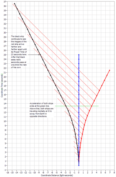

Here's a spacetime diagram to illustrate your scenario. The Earth observer is the thick blue line and the two ships are the other thick lines accelerating away from Earth in opposite directions until they reach the speed of 0.5c relative to the Earth's IRF. The red ship emits signals every second and their path to the black ship is shown as the thin red lines. Eventually, the black ship sees the red signals coming in at one-third the rate of his own clock. At that time, the relative speed between the two ships is 0.8c. The dots mark off one-second intervals of time called Proper Time for all observers.
Spacetime diagram with coordinate distance in light-seconds on the horizontal axis and coordinate time in seconds on the vertical axis. A thick blue vertical line marks Earth. A black ship's worldline curves up and left, and a red ship's worldline curves up and right, with thin red signal lines between them.

Mfb has helped you to see that you don't want to ignore Doppler. That's precisely what you are looking for.

Actually, you probably should think in terms of three parts because the left-ship (black) does not immediately see the right-ship's signals at regular intervals. So during this intermediate time interval, both ships have reached their final speed but the left-ship has to wait some time before he sees this effect in the right-ship.
Albertgauss said:
...these intervals--via time dilation--are perceived to be longer time intervals for left-ship compared to right-ship, but they are constant time intervals nonetheless. Of course, since the right-ship and left-ships are well separated in distance at this point, left-ship knows everything going in the right-ship—time_dilated/length_contracted/etc---to have happened a long time ago. Left-ship knows that, as the ships continue to separate, what left-ship sees is happening on right-ship happened longer and longer ago, but the interval between snapshots remains the same.
Is this all correct?
It's very close. It's important to understand that the left-ship cannot see or even be aware of the Time Dilation or Length Contraction that is going on with the right-ship. Indeed, in the Earth's rest frame, both ships are always Time Dilated and Length Contracted to the same extent throughout the scenario.

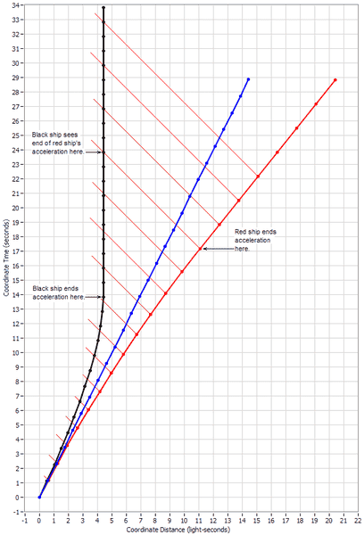

Also, when you refer to the frame of the left-ship or the right-ship, it's not clear what you have in mind since they are both non-inertial. However, we can consider the frame in which the black observer is inertial after he is done accelerating and look at that frame:
Spacetime diagram with coordinate distance in light-seconds on the horizontal axis and coordinate time in seconds on the vertical axis. A blue Earth worldline runs straight up from the origin, with black and red ship worldlines accelerating away in opposite directions, and thin diagonal red light signals drawn between them.
What you should notice in this diagram is that nothing changes as far as what the black ship observes of the red ship. The Time Dilations are all different in this frame. That should provide evidence for you that the Doppler is not caused by Time Dilation. Doppler does not depend on the frame while Time Dilation is and they differ by a factor of 2 to 1 as you approach the speed of light. They are two different kinds of things.

The problem with associating the "slow motion" Doppler images with Time Dilation is that if the ships were moving towards each other, the Doppler images would be "fast motion" even though the Time Dilation would be "slow motion".

What I was trying to point out is that the Doppler that each observer sees is the same in all IRF's but the Time Dilation is different.
