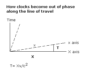

One more question related to the same scenario from wikibook
1) How do you interpret the leaning forward of the time and x axis?
Can you give some hints from the attached image?
2)
The book says (Bill and John are moving from each at [tex]v[/tex])
So distances between two points according to Bill are simple lengths in space ([tex]X[/tex]) whereas John sees Bill's measurement of distance as a combination of a distance ([tex]x[/tex]) and a time interval:
[tex]x^2 = X^2 - (cT)^2 -----(1)[/tex]
But Bill's distance, [tex]x[/tex], is the length that he would obtain for things that John believes to be [tex]X[/tex] metres in length. For Bill it is John who has rods that contract in the direction of motion so Bill's determination "[tex]x[/tex]" of John's distance "[tex]X[/tex]" is given from:
[tex]x = X\sqrt{1 - v^2/c^2} -----(2)[/tex]
Eq. 2 is from the Lorentz tranform and Eq. 1 is from the space-time interval definition
But why does Eq. 1 has only [tex]T[/tex] from B's frame but not [tex]t[/tex] from John's frame?
Can u pls give some advice?
Actually I'm a bit confused as to how the interpretation that a moving objects are out of phase by [tex]T = (v/c^2) X[/tex] is derived. From that onwards I tend to wonder whether
the wikibook is correct and questioning everything... really sorry if this is a silly question...
  • Spacetime diagram titled How clocks become out of phase along the line of travel, with Time on the vertical axis and a dashed tilted X axis, a solid X axis, a dashed line marked T, and the formula T = Xv/c^2.
