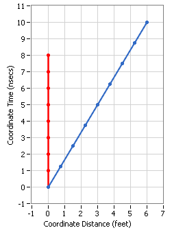

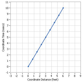

The quickest, easiest and best way that I know of to understand Special Relativity is to learn how to do Lorentz Transformations and to plot your scenarios on spacetime diagrams representing Inertial Reference Frames (IRF's). And the LT's are easiest to do if you use units where the speed of light is equal to 1 so you don't have to carry around the factor of c. In this example, I use units of feet for distance and units of nanoseconds for time and I define the speed of light to be equal to 1 foot per nanosecond. I will call your objects "observers" because we will want to see what they can observe and how they make measurements.
We start with the spacetime diagram for an observer stationary in a frame. I just show a short period of time:
Spacetime diagram of a stationary observer's worldline: a vertical blue line at coordinate distance 0 feet, with dots marking time from 0 to 8 nanoseconds on axes labelled Coordinate Time (nsecs) and Coordinate Distance (feet).
Note that we commonly make time go up and the progress of time for the observer is shown by the dots along his worldline.
Now we want to see what it will look like if the observer were traveling at some speed v. I will use a speed of 0.6c which is the same as 6 feet in 10 nsecs. To do this, we transform the coordinates of the events (dots) of the scenario to a new speed of -0.6c:
Line graph of coordinate time (nsecs) against coordinate distance (feet), a straight blue line rising from the origin to about (6, 10) with dots marking points along it.
Now you will note that time for the observer has been stretched out or dilated with respect to the coordinate time of this IRF.
Next we want to add in another observer who is stationary in this IRF:
Spacetime diagram with coordinate distance in feet on the horizontal axis and coordinate time in nanoseconds on the vertical axis. A red vertical line at distance 0 has dots at each time from 0 to 8, marking a stationary observer. A blue line from the origin rises to distance 6 at time 10, with dots marking the moving observer's worldline.

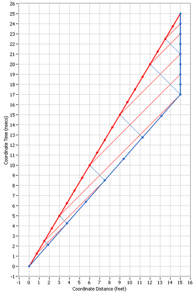

Now we are ready to deal with your scenario. Observer A is depicted in red and observer B is depicted in blue.
ChemicalCarl said:
From the way special relativity has been described to me, it is allowable to take a reference frame that is stationary with object A,

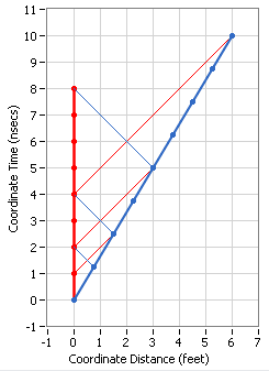

The way that these observers determine what is going on around them is to use radar signals that work like a laser rangefinder plus can be used for determining relative velocity. We assume also that they can observe the time on the other observer's clock as well as their own. We assume that both observers have set there own clocks to zero at the start of the scenario. You will have to count the dots to see what time is on their own clocks at each location.
Now I'm going to add in some radar signals, traveling at the speed of light (along 45-degree diagonals). Each observer sends out a radar signal at their own time of 1 nsec and observes that the reflection gets back to them at their own time of 4 nsecs (count the dots for the blue observer). They also observe that the other ones clock was displaying 2 nsecs when the reflection occurred:
Spacetime diagram with coordinate distance in feet on the horizontal axis and coordinate time in nsecs on the vertical axis; a red vertical worldline at distance 0 with dots at each nsec, and a blue diagonal worldline with dots from (0,0) to (6,10), with diagonal light-ray lines crossing between them.
So here's what they do with the information: They assume that the "time" of the radar measurement was the average of the "sent" time and the "received" time, in this case (1+4)/2 = 5/2 = 2.5 nsecs. And they assume that the relative distance to the other observer was the difference between those same two times divided by 2, in this case (4-1)/2 = 3/2 = 1.5 feet. And remember the time on the other observer's clock was 2 nsecs.
Meanwhile, they have sent out another radar signal at their own time of 2 nsecs which they each receive when their own time was 8 nsecs and 4 nsecs was observed on the other ones clock.
And as before, they determine the time of the second radar measurement to be (2+8)/2 = 10/2 = 5 nsecs and they determine the relative distance to the other observer to be (8-2)/2 = 6/2 = 3.0 feet.
Now they are ready to calculate the time dilation of the other ones clock. They do it by taking the difference in the determined times of the radar signals divided by the difference in the observed time on the others clock, in this case it would be (5-2.5)/(4-2) = 2.5/2 = 1.25.
They can also measure the relative speed of the other observer by taking the difference in the determined relative distance divided by the difference in the determined time difference. That would be (3-1.5)/(5-2.5) = 1.5/2.5 = 0.6.
All these observations/assumptions/calculations were done in observer A's rest frame and you can easily see that the distances, times, and velocity all comport exactly with the diagram for his rest frame. But observer B was also doing all the same observations/assumptions/calculations and he can do the same determinations (in a mirror image) but the above diagram does not agree with his determinations.

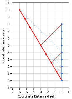

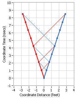

Now we transform to the rest frame of observer B and we can see that all of his determinations agree with the diagram:
Spacetime diagram with coordinate distance in feet on the horizontal axis and coordinate time in nanoseconds on the vertical axis; a red worldline moves diagonally from upper left to lower right while a blue vertical worldline sits at distance 0, with light-ray diagonals crossing between them.

You asked if we could pick a speed "half-way" between rest and observer B's speed in order to have both observers traveling in opposite directions at the same speed but this works at a speed somewhat higher than half-way, in this case 0.333c and here is a diagram depicting that:
Spacetime diagram with coordinate distance in feet on the horizontal axis and coordinate time in nanoseconds on the vertical axis; a red worldline moves left and a blue worldline moves right, with dots marking events and thin lines showing light signals between them.

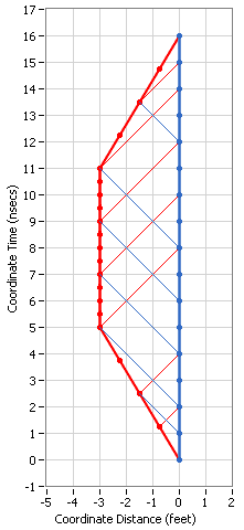

The twin paradox explanation in the book said that the person on Earth has to be the stationary object, as the inertial frame would have to decelerate/accelerate to stay with the person traveling, in order to make the return trip.

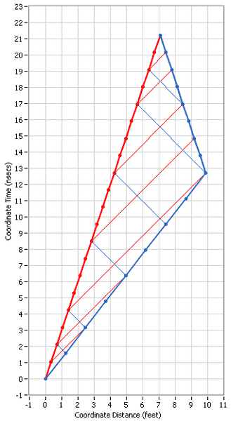

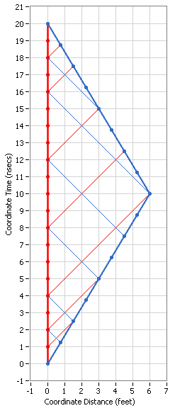

We can assume that the person on Earth remains stationary and analyze the scenario using his inertial rest frame and have the other person travel away and back. But we can also transform to the inertial frame in which the traveler is inertial on his way out and then to another frame in which he is inertial on his way back and we can even construct a non-inertial frame in which the traveler is at rest for the entire trip. We do this using exactly the same radar method plus observing the other ones clock that I described in my previous post.
I'm going to start with the same parameters that I used in the previous post. The red worldline will represent the inertial twin that remains stationary in his rest frame while the blue worldline will represent the traveler who turns around after 8 nsecs of his time and returns in 8 more nsecs of his time. (If the very short trip disturbs you, just change the time units to years and the distance units to light-years.):
Spacetime diagram with coordinate distance in feet on the horizontal axis and coordinate time in nanoseconds on the vertical axis, showing a vertical red worldline at distance 0 and two diagonal blue worldlines forming a V that meets at distance 6, time 10, with red and blue light-ray lines and tick marks.
Note how each observer continues to send out radar signals and receive their reflections but this time the new observations diverge.
Here is a summary of the measurements and calculations that the red observer makes of the blue observer's distance as a function of red's time, including the ones from the previous post plus his new ones:
Code:
Radar   Radar   Calculated   Calculated    Blue's
Sent    Rcvd      Time        Distance      Time
  1       4        2.5           1.5          2
  2       8        5             3            4
  4      16       10             6            8
 12      18       15             3           12
Note how his calculations exactly match what his rest frame depicts including the simultaneity of Red's Calculated Time and Blue's Time. (You have to count Blue's dots to see this.)

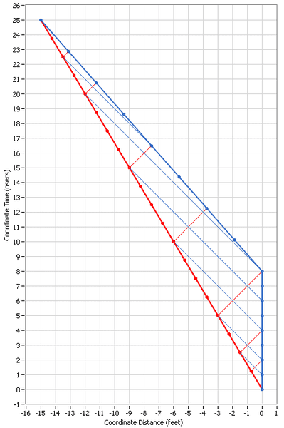

But now we want to do the same thing for the blue observer calculating the position of the red observer:
Code:
Radar   Radar   Calculated   Calculated    Red's
  1       4        2.5           1.5         2
  2       8        5             3           4
  4      10        7             3           8
  6      12        9             3          12
  8      14       11             3          16
 12      15       13.5           1.5        18
Now it's obvious that Blue's calculations of Red's position does not match the above frame but let's see what happens if we transform to Blue's rest frame during the outbound portion of his trip:
Spacetime diagram with coordinate distance in feet on the horizontal axis and coordinate time in inertial on the vertical axis, showing a red line and blue lines forming a sawtooth-like pattern of worldlines with red and blue tick marks.
This is definitely a step in the right direction as it agrees with the first two calculations of Red's positions but not after that.
Let's try the frame in which Blue is at rest during the inbound portion of his trip:
Minkowski spacetime diagram with coordinate distance in feet on the horizontal axis and coordinate time in nanoseconds on the vertical axis, showing two worldlines and red light-ray lines and grey construction lines.
Now this works for the last two calculations of Red's positions but not before.
It turns out that since Blue is not inertial we cannot transform to a frame in which Blue is at rest but we can construct one based on the information in the table. Here's what it looks like:
Spacetime diagram with coordinate time in feet-like units on the vertical axis and coordinate distance in feet on the horizontal axis; a blue vertical worldline at distance 0 and a red zigzag worldline going out to distance -3 and back, with thin diagonal light-ray lines between them.
You should be able to see that the bottom triangular portion of this frame matches exactly the bottom of the scenario in the second frame above and the top triangular portion of this frame matches exactly the top of the scenario in the third frame above. So all we have to do is fill in the remaining triangular portion in the middle as shown in the above diagram.
Now you should be able to see that this non-inertial rest frame for the blue observer matches all of his measurements, observations and calculations that he made earlier and compiled in the second table above. And, as always, all of the diagrams show the same observations for both observers.

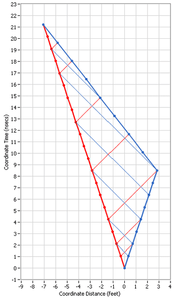

Since this thread is about using an inertial frame in which both observers are traveling away from each other at the same speed, I'm going to show you two more diagrams in which this is true for a portion of the scenario. Here is the one for the first portion of the scenario:
Spacetime diagram with coordinate time in nanoseconds on the vertical axis and coordinate distance in feet on the horizontal axis, showing a thick red worldline and a blue worldline forming a triangle with diagonal radar-signal lines between them.
And here is the one for the last portion for the scenario:
Spacetime diagram with coordinate distance in feet on the horizontal axis and coordinate time in nanoseconds on the vertical axis, showing two worldlines that leave the origin and meet again at a point near distance 10 and time 12.7, with red and blue dotted lines connecting points at equal times.
But note that it is not possible to combine the two portions of these two diagrams where the observers are moving at the same speed, at least I don't know how it could be done.
Any questions?
