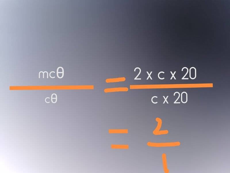

what is the numerical value of the ratio ?
Q=mcθ
Q=mc
the answer is 1/2 , but when I did the working out, I got 2/1.. so I'm quite confused

You have taken heat capacity / specific heat capacity instead of specific heat capacity / heat capacity.
Orodruin said:
But with regards to how the question (being ill posed) wants you to do things ...
how ..? isn't specific heat capacity = mcθ and heat capacity = cθ?
No.
Specific capacity is ‘c’ (lower case ‘c’).
Heat capacity is ‘C’ (upper case ‘C’)
C = mc
Warning: it's easy to mix up 'c' and 'C'!
That means you are simply being asked to find ##\frac c {mc}##.
