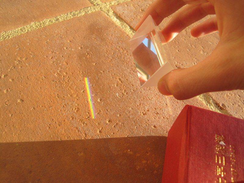

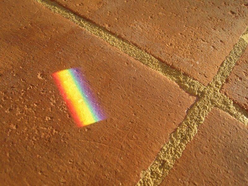

What do you mean as a good substance? What could be one?
I have already made rainbows from sunlight in the attachment.
What I wanted is to see a spectrum of a chemical and recognise the chemical from the emitted/absorbed lines.

I think you should get greater spreading of the spectrum than what you saw with the sun by using the technique with the slit and the lenses. You also can rotate the incident angle to optimize the results by putting the prism on a rotating table and turning it. If the prism is made of a glass that has good dispersive properties, you should get quite a lot of spreading of the colors. The one picture of the sun is reasonably good, but the results should get better with the slit and lens technique.

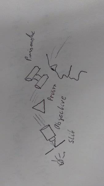

When I was a boy I used a slit made from two blades for shaving, colimated it with a lens from a photo camera and looked at the spectrum with some prismatics.

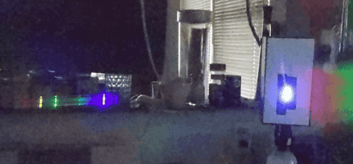

ps. Here are the comparative results of my experiment I just finished a few minutes ago:
Equipment:
Light source: black compact fluorescent lamp (mercury vapor)
plastic prism
1000 lines/mm diffraction grating​
mercury vapor emission lines through the prism
mercury vapor emission lines via diffraction grating​
My prism wasn't able to cast enough light onto a white screen, so I was forced to photograph it directly at the prism, losing two of my spectral lines. And the ones that are present, are not very well defined.
If you look through wiki's entry on the history of spectroscopy,
Early 19th Century (1800 - 1829)
In 1802, William Hyde Wollaston built a spectrometer, improving on Newton's model, that included a lens to focus the Sun’s spectrum on a screen. Upon use, Wollaston realized that the colors were not spread uniformly, but instead had missing patches of colors, which appeared as dark bands in the sun's spectrum. At the time, Wollaston believed these lines to be natural boundaries between the colors, but this hypothesis was later ruled out in 1815 by Fraunhofer's work.
Joseph von Fraunhofer made a significant experimental leap forward by replacing a prism with a diffraction grating as the source of wavelength dispersion.
you'll see that technologically, prisms were inferior to diffraction grating. So I would be surprised if anyone could do what you are asking, with even the best spectrums in the world.
This is just a guess of course, as I'm not really a scientist.

Ivan Samsonov said:
How could that work? Similar to a prism?
No, you need the prism, too.
The slit has to be in the focal plane of the objective.
