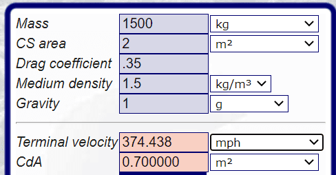

I do not believe it will reach 300 ##mph##. Consider that if the car was dropped from an aircraft it would not reach 300 ##mph## terminal velocity. Here is a terminal velocity calculator to ply with. Given a car in free fall with air drag on the order of 100-130 ##mph## it is only going to be less rolling down a ##30°## hill.
http://www.calctool.org/CALC/eng/aerospace/terminal
You would have a shot at reaching 300 ##mph## on Mars.
bob012345 said:
... Given a car in free fall with air drag on the order of 100-130 ##mph## it is only going to be less rolling down a ##30°## hill.

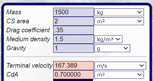

I get 374mph when I do that calculation with that calculator and realistic numbers. What numbers are you using?
My area was too big by 10x.
