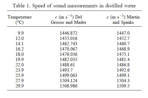

Just to make sense of some of the number discrepancies we are getting, let me refer to their Table 1 for the temperature dependence of water in distilled water:
The cited source for the first column is:
V. A. Del Grosso and C. W. Mader, J. Acoust. Soc. Am. 52, 1442-1446 (1972)
(I think the access to this paper is free)
The second column, of course, are the measurements by the authors of the paper we are considering.
Apparently the speed of sound in water is highly dependent on temperature.
From Fig.3 of the graph (the one linked in post #4), AlephZero deduced:
AlephZero said:
To see the plot, click the link in post #4. The values at the ends of the plotted range are
1519 m/s for 6% ethanol
1558 m/s for 12%
which would imply a speed of sound for pure water:
1519 + (0 - 6)*(1558-1519)/(12 - 6) = 1519 + (-6)*39/6 = 1480 m/s
Looking at the Table 1, this would correspond to a temperature:
19.9 + (1480-1481.4)*(19.9-18.0)/(1481.4-1475.1) = 19.9 + (-1.4)*1.9/5.7 = 19.9 - 0.47 = 19.4 oC
which is different from the quoted 20o C by 0.6 Co, a three times larger difference than the quoted temperature accuracy
The temperature of the medium was controlled by a laboratory heater/stirrer and measured with a calibrated platinum resistance thermometer (ETI Ltd, Worthing, UK) with an accuracy of ±0.2°C.
Maybe they had some issues with temperature stability of the mixtures.
