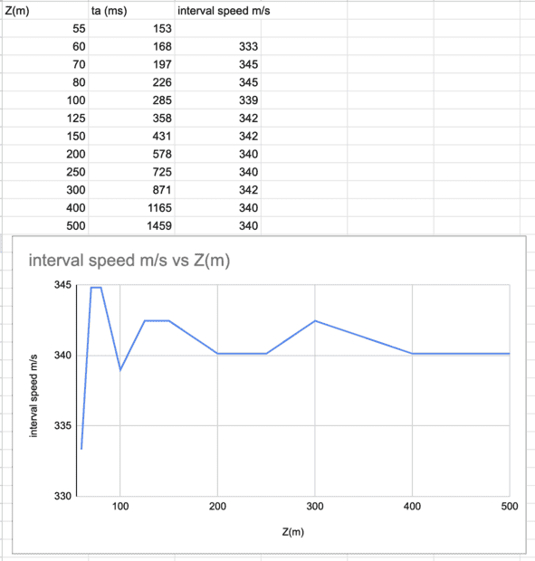

By computing the speed between each pair of data points using Vi = (Zi - Zi-1) / (ti- ti-1) with the provided data, you will observe a consistent interval speed of 340 m/s from 70 metres to 500 metres.Baluncore said:Gilbert F. Kinney and Kenneth J. Graham - Explosive Shocks in Air. 2'nd Edn. 1985.
Table XI, page 254, shows one kilogram of TNT as being supersonic to beyond 500 metres. From 100 m to 500 m, the velocity falls by only 0.2%.
Could you please provide more details about the meaning and implications of the "only 0.2%?"
Frabjous
- 1,978
- 2,445
I do not understand why you are differentiating the data when the Mach number is given.Squizzie said:By computing the speed between each pair of data points using Vi = (Zi - Zi-1) / (ti- ti-1) with the provided data, you will observe a consistent interval speed of 340 m/s from 70 metres to 500 metres.
I've plotted the 1 kg HE data from Kinney. I plotted the full range of the Mach Number and a limited range of the Mach Number as a function of distance.
Please identify where you would start your "blast regime” given that the propagation speed is asymptoting to the sound speed.
Fun fact, the pressure of the last point is about 140 dB.

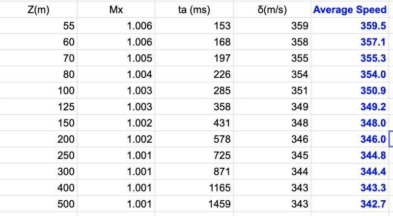

They give the accurate velocity as a Mack number in the Mx column.Squizzie said:Could you please provide more details about the meaning and implications of the "only 0.2%" ?
Z = 100 m; Mx = 1.003
Z = 500 m; Mx = 1.001
The difference is only 0.2%, but it is still supersonic at 500 m.
You are seeing numerical round-off noise from the tabulated data in your unnecessary re-computation. That explains why your graph jumps up and down about the speed of sound, while the shock front remains supersonic throughout.

I think we are both correctly interpreting the data in table XI as it relates to the progress of the shock front as explained on p. 96 of Chapter 6 "Blast Waves":Baluncore said:How can it be a shock front if it is not moving faster than Mach 1.
" the peak overpressure values of Table XI also uniquely define the time required for that shock front to travel out to various distances. "
And I have previously identified p. 88 of the same chapter:
"Each individual portion of this pulse moves outward at its own speed, which also is the speed of sound in its own immediate medium. "
So I'm not convinced that your evidence is sufficient to support your contrary conclusion that the shock front was propagating at anything other than steadily at Mach 1 by 100 metres and 280 ms.

Yes, and you are saying that the data they present is wrong. You did not know about it when you started this thread, and now you believe that you can correct it.Squizzie said:Is not Kinney and Graham, from whom I'm drawing my reference, the standard text?

If you are suggesting that I am contradicting the data in Table XI, I should point out that the"δ(m/s)" and "Mx" values reported in Table XI represent the average speed (Z(m)/ ta), not the interval speed.Frabjous said:Yes, and you are saying that the data they present is wrong.
I attach a screenshot of my working, highlighting the detail that the δ(m/s) values in the table are in fact the average values that can be deduced from the data, not the interval values.
Since the speed is decreasing from an initially very high value, the average speed values will approach asymptotically to Mach 1, obscuring the fact that, as my post #224 above clearly shows, the interval, or instantaneous speed of Mach 1 is achieved after about 50 metres from the blast.
