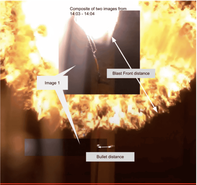

I have extracted a couple of frames at around 14:03 during the 100,000 frames/sec video of the explosion. We can see the detonation front moving at around 10x the speed of the bullet.
High-speed video frame of a fireball from an explosion with a composite inset of two frames labelled 'Composite of two images from 14:03 - 14:04', marked with 'Image 1', 'Blast Front distance' and 'Bullet distance' arrows.
The bullet's velocity is reported at 1250 ft/sec which is around Mach 1.1, so the detonation front must be travelling at around Mach 10. Does the observation, at 12:10, that the shockwave and the bullet arrive at the target, some 5 metres down range, at about the same time, indicate that the shockwave is moving at a similar speed as the bullet, i.e. the shockwave from the detonation is propagating at Mach 1? (the shockwave has had a bit of a head start as it was being generated at Mach 10 the first few microseconds)
The shockwave will lose speed as it travels, eventually turning into a normal sound wave that moves at the speed of sound. I don't know how quickly the shock wave in the video loses speed though.
Most (explosive-based) bullets travel quite aways before they go subsonic ; I guess that was a pistol round, probably coming out of a (relatively) short barrel. C4 (the actual explosive component) is very fast, detonating at IIRC 17k ft/sec, give or take. (Wp says about 1.5x as fast).
I'm not sure where you're getting "Mach10" for the expanding gas as it leaves the barrel right after the bullet (ie: the "shockwave"). Interesting that it hits at the same time as the bullet, but maybe they did some quick calcs and tried a few times with different ranges before they got it to match.

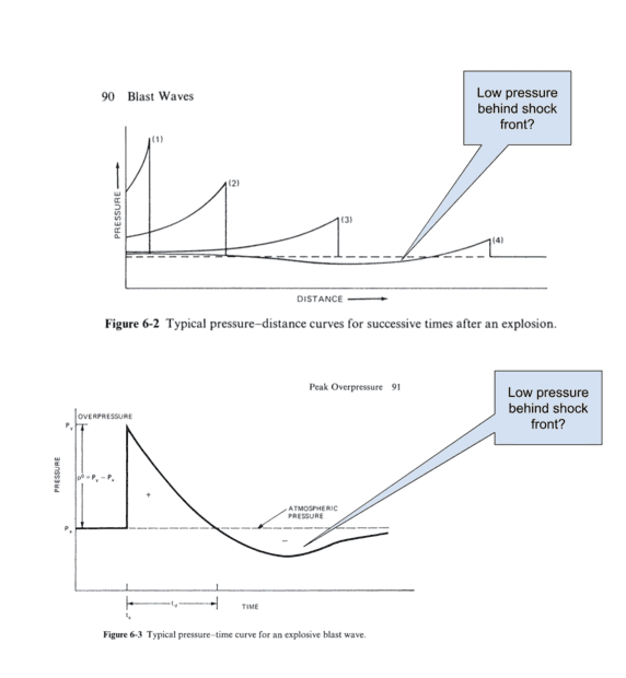

The fireball shown in the video may have been at a lower than normal pressure, since the shockwave had passed, ahead of the combustion gasses. I would recommend an optical technique to make the density of the shock wave visible, against a detailed background, while setting up the timing for that devious bullet experiment.
When I said the "detonation front", I was referring to the C4 detonation, not the bullet. At 8:09 they display the speed of the explosion at 3326 m/s , that's around Mach 10 in air at STP, and the speed of the bullet at 387 m/s , which is Mach 1.1
The composition (molecular weight) of the C4 combustion products, and their temperature, determines the early average velocity of the initial fireball front.
A detonation front travels through the raw explosive material, prior to, and triggering, the chemical reaction and energy release. It starts at the detonator, booster, or gaine.
The fireball front is a mixing, or inter-fingering, of hot combustion products with air being pushed out of the way.
The fast and bright sparks, could be grains of aluminium dust from commercial C4, burning in air ahead of the fireball front. Commercial explosives contain a chemical indicator signature, that can be traced back to the manufacturer and batch number of the explosive material.

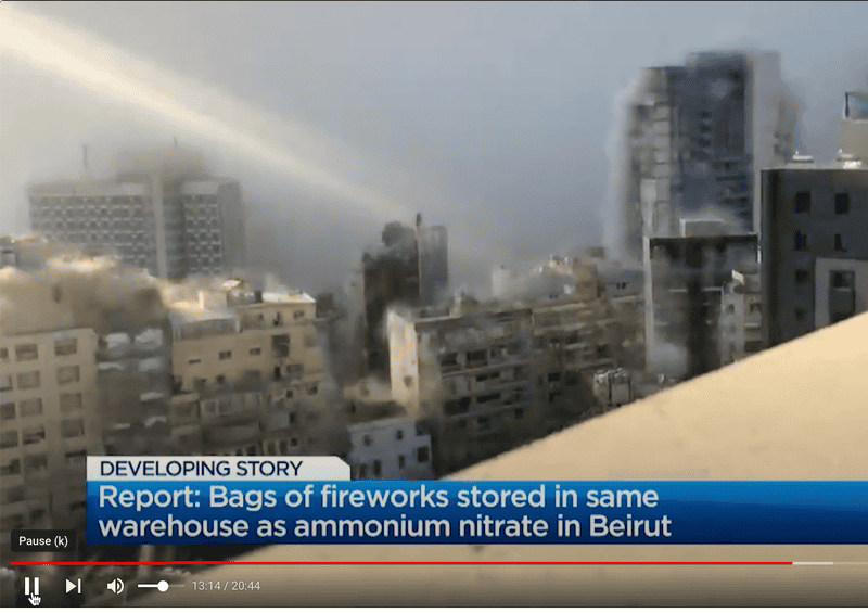

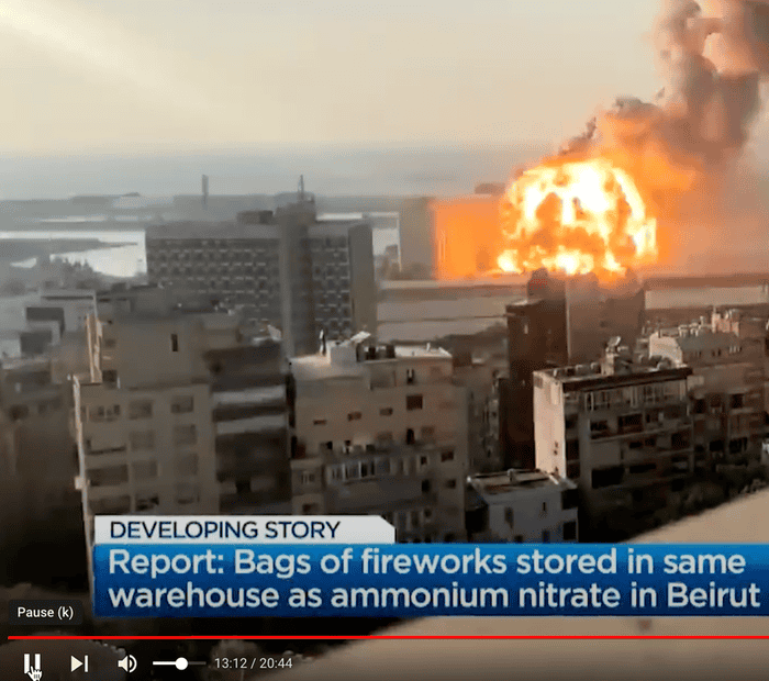

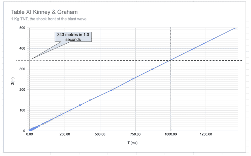

I have conducted further research on the experimental determination of the speed of shock waves in air and found this video of the August 2020 Beirut Ammonium Nitrate explosion
youtube.com/watch?v=QQkmJI63ykI&t=792s

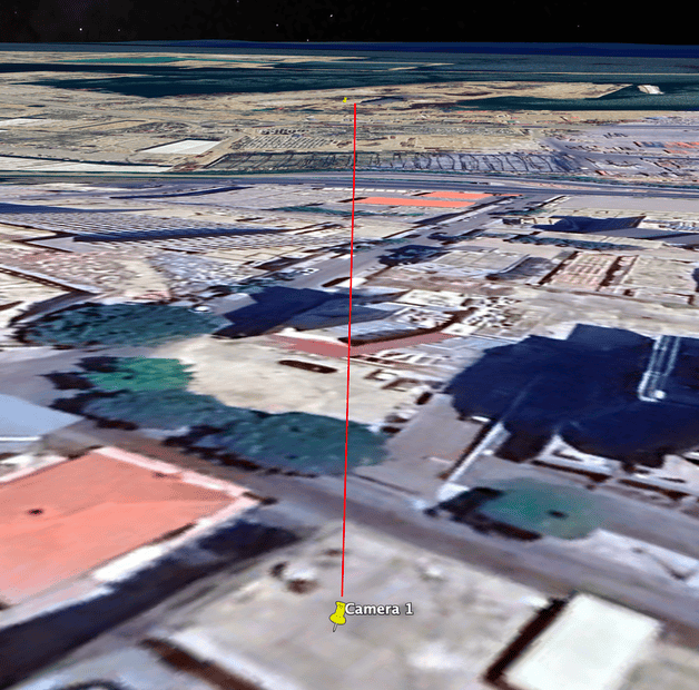

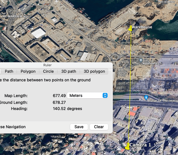

A brief investigation in Google Earth identifies the camera position to be approximately 670 metres from the warehouse, and the shockwave taking 2 seconds to reach that location, giving a speed of around 340 m/sec - Mach 1
Explosion at #13:12
Still from a news broadcast showing a large orange fireball and dark smoke rising behind rows of apartment blocks by the coast. Caption reads: Developing Story. Report: Bags of fireworks stored in same warehouse as ammonium nitrate in Beirut.
Arrives at the camera location at 13:14
Still from a news broadcast showing a hazy cityscape of apartment blocks with dust clouds rising, captioned: DEVELOPING STORY. Report: Bags of fireworks stored in same warehouse as ammonium nitrate in Beirut
Estimate of the camera position:
Google Earth 3D view of an urban area with a red line running from a yellow pin labelled Camera 1 in the foreground toward the distant background.
Distance from explosion: 677 metres:
Satellite map of Beirut port with a yellow ruler line from a marked Warehouse to Camera 1, reading Map Length 677.49 Meters, Ground Length 678.27, Heading 140.52 degrees.

Not quite the correct terminology. A shockwave ceases to exist at Mach 1.
For a shockwave to propagate, there has to be sufficient compressive energy to heat the air, to maintain the speed of sound above Mach 1. The back of the shockwave is pushing the front, maintaining the step transition.
A short distance outside the plasma or fireball, expansion will have cooled the gas, which can then be treated as having a fixed temperature. The step in pressure, is then deemed to be, too small to heat the air.

But wasn't the phenomenon that struck the camera operator 2 seconds after the Beirut explosion, described in my post #10, a shock wave?
Squizzie said:
But wasn't the phenomenon that struck the camera operator 2 seconds after the Beirut explosion, described in my post #10 a shock wave?
The explosion would have produced a shockwave initially, but an average of Mach 1, over two seconds, suggests that it did not remain a supersonic shockwave for long, it was the decaying step transient.
The explosion was not a point source, and there were reflections, so the radiation pattern would have been subjected to constructive and destructive interference.
Listen to the sound of the step. Was it a click, or were lower frequencies present? Was the audio system capable of reproducing the spectrum of a shockwave?

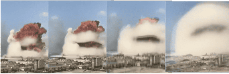

But consider the white dome we see expanding from the same Beirut explosion.
Four side-by-side frames of a large explosion cloud over a city, with a white dome expanding outward and a reddish-brown fireball at its top, the dome growing larger from left to right.
This is the phenomenon that was captured on camera in my earlier post.
This is what travelled at Mach 1 from the explosion.
Isn't this a shockwave travelling at Mach 1?

Does your opinion of the meaning of "shockwave" in a physics setting have definable boundary limits on velocity ?
[edit: mostly garbage removal, based on a temporary brainfart that wave propagation goes subsonic]
No, that's not the shockwave. Look at the white circular area at the water. I believe that's the shockwave. The white dome is water vapor condensing into droplets in the low-pressure phase of the explosion. This takes place up to several hundred milliseconds after the peak overpressure part of the wave passes by.
No. That is condensation of water in the air. It results from the pressure falling below one atmosphere following the outward momentum of the shock wave. The shock wave is well ahead of that cloud of condensate.
The buildings and trees that are hit by that white hemisphere are wet, like it has rained sideways on them from the direction of the explosion.
pic#4: the light-blue sliver on the left of the steam ball ; IMO, that's either your shockwave or the leading edge of the low-pressure zone.
Just look at these images.
There's the orange smoke from the explosion shooting up and then hanging there.
There's the white dome appearing after the appearance of the orange smoke and then quickly obscuring the orange smoke.
Is it steam, water vapour or cloud (water droplets)? Is it hot or cold? High or low pressure? Does it delineate a boundary? Does it leave trees wet?
Then there's the silver disk expanding on the water.
What is it?
Why is it silver?
Is it the base of an invisible shockwave?
Does the shockwave contain wind gusts of 760 kph?
And those four frames are captured over about one second!
