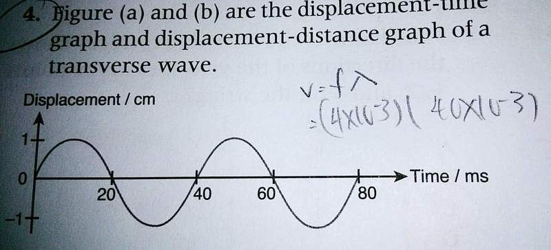

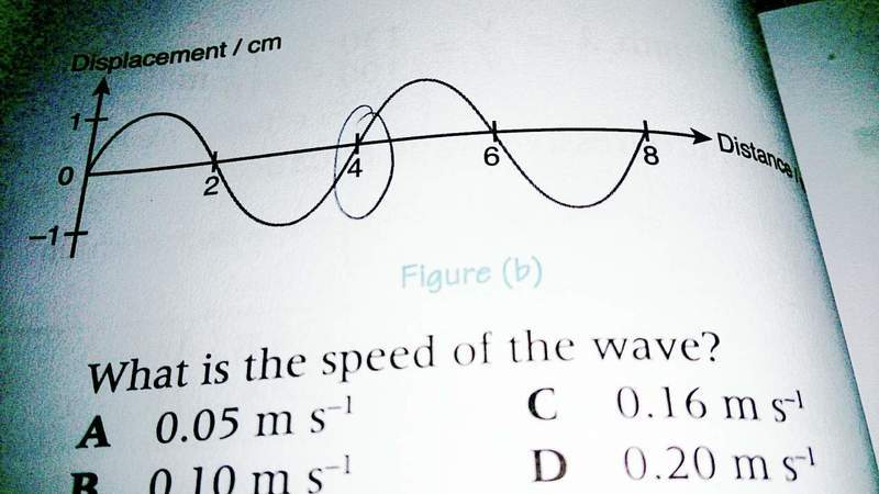

my working is as in the photo which is v=f X wavelength = 0.4 X 0.04= 0.16 ... but the ans given is 0.10m/s

The value you got for the frequency f is not correct.
Also 0.4 * 0.04 = 0.16 isn't a correct equation.
sorry... my working should be ( (40X10^-3 )X (4X10^-3) )/100= 0.016 m/s .. which part is wrong?
Your second diagram is not clear. Distance in what?
How about betting on mm ?
But poor Des is still looking at the wrong frequency. He may be confused by the label on the x-axis of graph a.
Des: you see there one full period ends at the number 40. that is the period divided by ms.
Meaning: ##{period \over ms} = 40\, ## so that period = ??
What is the dimension of frequency ?
Graph b x-axis label is distance / mm but there he has no problem extracting ##\lambda## = 4 mm.
Des: Now, do you see where you ended up upside down ?
