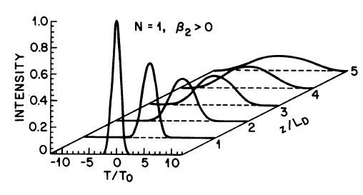

I am trying to write a very basic Matlab code to preform the split-step Fourier method on the nonlinear Schrodinger equation:
$$\frac{\partial A(z,T)}{\partial z} = -i \frac{\beta_2}{2} \frac{\partial^2A}{\partial T^2} + i \gamma |A|^2 A \ \ (1)$$
I want the program to make 3D plots of Gaussian input pulses (##A(0, T) = \sqrt{P_0} exp (-T^2/(2T_0^2))##) propagating over different distances. It should look something like this:
Attempt:
Here is my code (I chose some dummy values to check whether the code is working):

But the code doesn't work. There is no graph generated and I get the message that "Matrix dimensions must agree" I think because omega is a 1 by 15 row vector, and so is exp(v.*D), but v is a different size. How can I fix this?
Is the overall structure of the code correct or do we need to do this differently?
Any help would be greatly appreciated.

The frequencies appearing in D are governed by the FFT and depend on the size and length of the spatial grid. You have calculate them correctly, and take into account the special order of the FFT data in reciprocal space (momentum space in your case). See for instance chapter 12 of Numerical Recipes http://www.nrbook.com/a/bookcpdf.php
Also, I strongly advise against using the asymmetric split you are using. You should use ##e^{h \hat{D}/2} e^{h \hat{N}} e^{h \hat{D}/2}## or ##e^{h \hat{N}/2} e^{h \hat{D}} e^{h \hat{N}/2}##. Have a look at http://iopscience.iop.org/article/10.1088/0305-4470/39/12/L02
