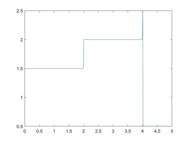

I wrote some code that is supposed to give me the step function:
Matlab:
function y=step_fn(x,a,b)
%This is the step function, given a range from a to b, it wil produce a
%function which is 1 from a to b and zero otherwise.
L=length(x);
y=zeros(1,L);
n=find(x<=a,1,'last');
if (b==max(x))
    m=L;
else
    m=find(x>=b,1,'first');
end
if (n==1)
    y(n:m-1)=1;
else
    y(n+1:m)=1;
end
This all looks good, however when I do the following:
Matlab:
x=linspace(0,5,500);
D=1.5*step_fn(x,0,2)+2*step_fn(x,2,4)+0.5*step_fn(x,4,5);
I get the attached plot. I don't quite understand . Does anyone understand where I am going wrong?
I get similar odd results with the smooth approximation using the erf function.
  • MATLAB line plot of a piecewise constant function on x from 0 to 5: height 1.5 up to x=2, 2 from 2 to 4, then a spike near x=4 to about 2.5 before dropping to 0.5 for x from 4 to 5.

You are checking the boundaries using <= and >=, meaning that both extremities get included. In other words step_fn(x,2,4) returns 1 for x=4, and step_fn(x,4,5) also returns 1 for x=4, so the two get added up. The only reason it doesn't happen at x=2 is that , for some reason, you decided to exclude the last point if the interval starts at the first point in x, so step_fn(x,0,2) returns 0 for x=2.
You need to decide which of step_fn(x,a,b) or step_fn(x,b,c) equals 1 when x is exactly b (or set step_fn(x,a,b) to return 0.5 when x is exactly a or b).
BTW, an easy MATLAB step function looks like this:step_fn = @(x,a,b) x>=a & x<=b;
