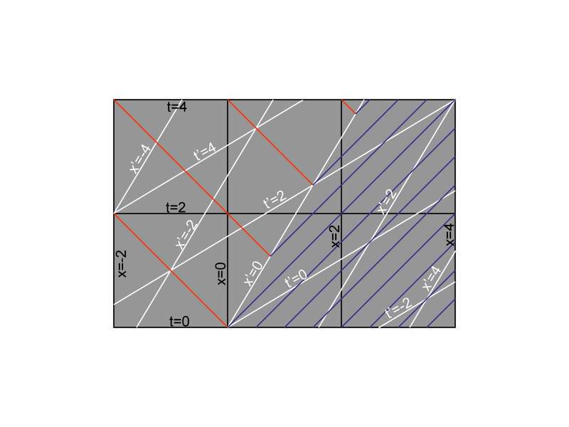

Here is a spacetime diagram of the Doppler shift from a 1 Hz source moving at 0.6c to the right (Doppler shift factor of 2). Hopefully it helps clear things up, everything is there.
Thanks for the diagram DaleSpam.
Please correct me if I'm wrong, but I believe that the diagram shows the total SR Doppler redshift, but it doesn't separate that redshift into its classical and SR time dilation components.
I'm trying to dissect the 'physical' explanation for why the classical Doppler effect is always more redshifted than the SR Doppler redshift; that is, why introducing SR time dilation always causes the classical Doppler redshift to shift toward the blue spectrum, never toward the red.
The physical explanation is simply that the classical formula is wrong, it is an approximation that is only valid for v<<c. When that assumption is violated it biases the answer blue (i.e. neglects time dilation which always reddens).
Note that length-contraction is not an issue here, study the diagram to convince yourself of that. The speed of light together with the frequency determines the wavelength, it is not independent. Remember what length contraction is: a reduction in length from the rest frame to some other frame. There is no rest frame for light.
As I said, it's not true that classical Doppler shift biases blue, instead it biases red, which is quite counterintuitive. Please look at the graph I linked to in post #1 of this thread. Try the math I set out.
Surely the distance between the emitter and the observer is Lorentz contracted.
EDIT: I printed your diagram and measured the purely vertical distance between the t'=0 and t'=2 lines at ~ 1.25 inches. The same for the purely horizontal distance between the x'=0 and x'=2 lines. By comparison, the vertical distance between the t (unprimed) lines is ~ 1.5 inches, same as the horizontal distance between the x (unprimed) lines. So your diagram seems to indicate that t' and x' are time contracted and distance contracted respectively, relative to t and x. The time contraction seems counterintuitive, which is my point.
Put it this way, suppose we lived in a universe with totally Newtonian laws of physics, with no natural length contraction or time dilation; then if you have a clock moving along with an emitter measuring the frequency of pulses being sent out, and you compare that with the frequency of pulses being received by an observer who sees the emitter in motion (as measured by his own clock, which of course naturally remains in synch with the emitter clock in a Newtonian world), then you have the classical Doppler shift formula. Now, suppose in this Newtonian world we artificially slow down the clock moving along with the emitter by a factor of [tex]\sqrt{1 - v^2/c^2}[/tex], where v is the velocity of the emitter relative to the observer; if you now compare the frequency of the pulses being sent from the emitter as measured by the artificially-slowed down clock with the frequency of the pulses being received by the observer as measured by his normal clock, you get back the relativistic Doppler shift formula.
Not relevant, because the only thing you need to calculate the relativistic Doppler shift is the difference between the distance of the emitter when one pulse is sent and the distance when the next pulse is sent, and just as in Newtonian physics this is simply the velocity of the emitter in the observer's frame times the time interval between pulses being sent in the observer's frame, length contraction doesn't figure into it because nowhere are you concerned with the distance between things in the emitter's frame.

Since all galaxies are separating away from each other, observers on those galaxies won't find themselves naturally meeting up in a way where they can directly compare their clocks and their rate of aging. In theory however they can synch up their clocks by exchanging electromagnetic signals (provided they are within our event horizon). Then they can calculate indirectly that they are aging at the same rate.
If we could view images of people on distant galaxies through telescopes (a remote prospect at best!), the Doppler effect won't make them look older or younger per se. The cosmological redshift (which I believe contains an element of Doppler effect) will shift their images toward the red end of the spectrum. And because of the time delay for the signal to arrive (due to the finite speed of light), we will see images of how they looked when the light left their galaxy, not what they look like now. The cosmological redshift also stretches out photon trains in the same proportion as the redshift (z + 1), so in the images we see, the people will be moving and aging in slow motion. Although we currently can't resolve images of the size of people, we can resolve images of distant supernova events (which have a known range of cycle times), and by measuring them it has been observed that the aging of the supernova process appears to us to be slowed down exactly by the factor of z + 1. This doesn't mean clocks are running slower there, it simply means that the photon train got stretched while in transit to us.
JesseM said:
Not in general it's not. The wavelength of a wave in your frame is defined as (velocity of wave in your frame)/(frequency in your frame)--of course in relativity if you're talking about a light wave and using units where c=1, then this becomes 1/frequency. But in a classical world where you're using the classical velocity addition formula it's impossible that a given wave could have the same velocity of c in both frames--in my example from post 16, since the emitter was moving at 0.6c relative to the aether and it aimed the wave in the opposite direction it was traveling, that means that in the emitter's frame the speed of the wave was 1.6c. So, with a frequency of 1/12.5 s^-1 (i.e. one cycle every 12.5 seconds) in the emitter's frame, the wavelength was (1.6c)*(12.5 s) = 20 light-seconds. Do you disagree with the numbers in this example?
OK I see, you are trying to construct how a completely classical (non-relativistic) model would work. In that sense your calculations may be correct. But of course they do not reflect reality in a relativistic universe, and its not a tangent I want to pursue in this thread.
I am not trying to suggest that we live in a non-relativistic universe. The only reason I'm thinking through the classical Doppler shift is that I'm trying to construct how the cosmological redshift might be physically explained (other than by the wave crests being forced apart by 'expanding space', an explanation that has attracted considerable skepticism). In a model governed by the FRW metric, no relativistic time dilation occurs as between comovers. SR Doppler redshift with the SR time dilation factor (gamma) removed is classical Doppler shift. I don't interpret this to mean that the FRW metric is anti-relativistic, since after all it is an exact solution to the Einstein Field Equations. But when applying the metric, one is compelled to play by the rules ingrained in the metric. SR time dilation does play a role in an FRW model, but it is a role that proscribes proper time dilation as between fundamental comovers.
I thought the point of this thread was to compare the classical Doppler shift with the relativistic Doppler shift, and that you were saying the light is "more blueshifted" in the relativistic case than the classical one (which I disagree with). Wasn't that what you were talking about in the OP?
I wasn't suggesting you were, but I thought you wanted to compare the predictions we would make if we lived in a non-relativistic universe with the actual predictions we make in our own relativistic universe.
Your OP didn't discuss GR or cosmology, though. Anyway, what does "physically explained" mean? You mean you want some kind of conceptual verbal explanation, as opposed to just being satisfied that this is what is predicted mathematically by GR in a FRW spacetime? Are you saying you think it's somehow important for physicists to have such a conceptual explanation beyond the math, or do you just think it would be useful from a pedagogical point of view or something?
