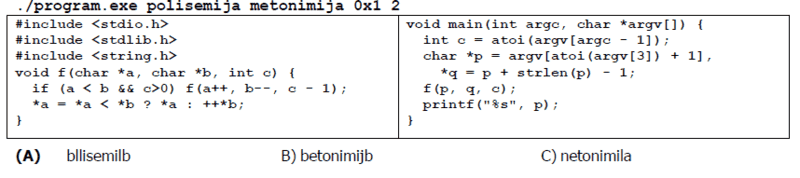

Analyze the code below and figure out what it outputs if it's started with this command:
The correct solution is given so i can better understand the parts of the problem.
3. The Attempt at a Solution [/B]
I had typed it out and tried to get the same result on Visual Studio 2017 by passing it's command to Visual Debugger Command line Argument and it keeps outputting
Maybe i did something wrong with the command line? I do not know. I continued to analyze it by hand and i had a few questions along the way that were stopping me from figuring it out. Here is fully typed out and annotated code in which i showed my understanding of it.

I wanted to stop at this point to make sure my i typed in everything correctly as i do not get the right result. What is wrong here?

Minor point -- your code is missing the final right brace at the end. You must have not copied it, since your code actually compiles and runs.
When you run your program, argc = 5, argv[0] contains the name of the program, argv[1] is "polsemija", argv[2] is "polisemija", argv[3] is "0x1" and argv[4] is "2".
The expression atoi(argv[3] is 0, not 1 as you show in your comment. The reason is that atoi("0x1") evaluates to 0, since 'x' is not a decimal digit. (See http://www.cplusplus.com/reference/cstdlib/atoi/?kw=atoi for more information.)
So argv[atoi(argv[3]) + 1] is argv[0 + 1] or argv[1], which is the string "polisemija", and p contains the address of that string. I don't know why your debugger shows a different string.

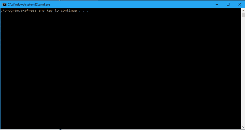

Is this where i was suppose to write the command argument? Maybe there is something wrong with this. Also here is a debugging screenshot:
It shows that p is the first parameter of the argument but it should be the argv[1] = "polisemija" like you said and not this.
Don't include the program name in the command arguments. The program name (and path) is already argv[0], so you're essentially getting it twice by making it argv[1].
Also, the argv array should contain 5 values, not the 6 that you show.
That was it! Without the program name it runs fine. But i can't still get the result by analyzing. Some thing aren't clear to me.
