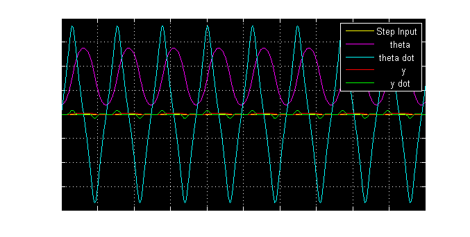

Hopefully someone here knows how to "write a state description of the nonlinear system." I did keep moving forward, and simulated the system in MATLAB SIMULINK by just creating a diagram of the given equations.

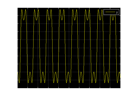

My new question is, do these plots make sense in a frictionless environment? I'll attach the plots, but basically the position keeps teetering back and forth without actually making any total displacement, and the pendulum keeps swinging perpetually, always reaching a the starting vertical direction (IE, if I set the initial condition at pi/4, it will swing to 7pi/4, then swing in the opposite direction back to pi/4.

Simulink scope plot on black background showing step input, theta, theta dot, y and y dot against time; theta dot oscillates with large swings and y stays near zero.
Yellow oscilloscope-style plot on black background with grid, a periodic signal oscillating between two levels with repeating double-peaked cycles; legend shows y.
Does this make sense?
