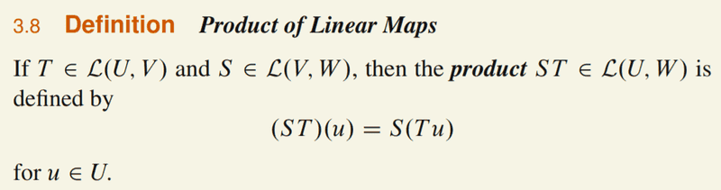

Given ##L: V \to V:v\mapsto L(v)## and the definition of product of linear maps (for instance, as found in enlightening Axler's Algebra done right book)
One finds that ##L \circ L: V \to V:v\mapsto L(v)##, so I would say this is a sufficient condition to assert that these two are equal.
Applied to ##S=T=L## we get ##L^2(v)=L(L(v))##. Nowhere is said that this equals ##L(v)## except in your proof. Look at my example matrix. It has rank ##2##, as has its square, a ##2-##dimensional kernel, and ##e_3=L^2(e_3)\neq L(e_3)=e_4## if ##e_3,e_4## denote the third and fourth basis vector. Yet, it is injective on ##\operatorname{im}(L).##
This is definitely not true in general. How are you proving this? Are you thinking that having the same range implies that they are identical? What about the linear function f(x) = 2x and f(f(x)) = 4x?
