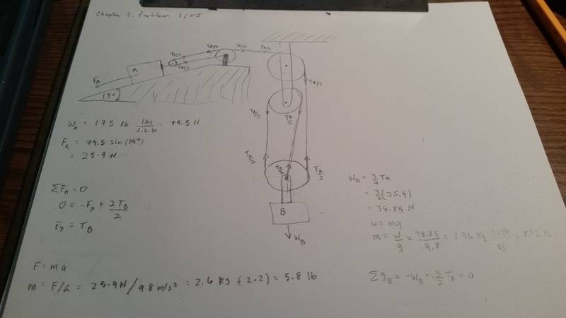

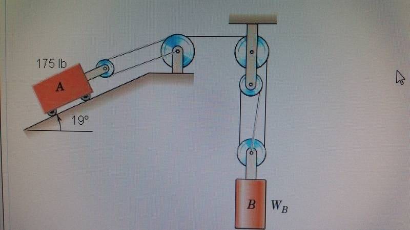

What weight WB will cause the system to be in equilibrium? Neglect all friction, and state any other assumptions.
ΣF=0

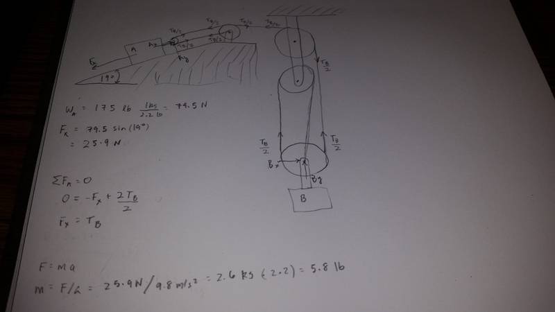

I can't figure out what I am doing wrong with these pully problems, I tried putting in resultant forces at pully A, but that just added another variable.[/B]
You should check the Wb is Tb or ___ ?
I did a redo of the tensions this time starting from A going to B, I am still missing something though. solving for weight at B i got 8.72lb (on the right side of my paper)
It seems correct to me.
Yea, but I am still missing something, its not the correct answer.
Oh, find the F again you will see the wrong :) 79,5 N or kg ?
If the weight of block A is 175 lb that is equal to 79.5N
ok i got, my mistake was trying to convert from english to standard, i should of just left it in english. thanks thypon.
No, 1lb is equal to 0,453 kg, so 175lb =79,27 kg
N means kg*m/(s^2)
N means kg*m/(s^2)
i got confused because 175 lb of weight = 175 lb mass.
Is it okay now ?
Thyphon said:
Is it okay now ?
yea its correct now. thanks
