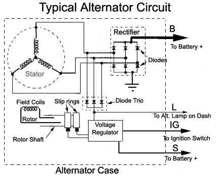

Typical automotive alternators I'm used to
Wiring diagram titled Typical Alternator Circuit showing a stator, rotor with field coils, slip rings, diode trio, rectifier diodes, voltage regulator, and outputs labeled B to Battery+, L to Alt. Lamp on Dash, IG to Ignition Switch, and S to Battery+.
The diode trio powers the regulator and field .
Old Bosch and GM and Fords in my day(70's) didnt have that wire from Ignition Switch, or that S(ense) wire.
Bootstrap was through the "Alt Lamp on Dash"which had a low ohm (maybe ten ohms) resistor soldered across its rear terminals. Without that resistor that tiny lamp won't pass enough current to get the alternator voltage up high enough to overcome the diodes until you wind the engine way up to about 4500 RPM.
So lots of alternators I'm sure have got replaced because of that ten-ish ohm resistor behind dash ALT light burning open. I hope you got one of those , it'll be okay. You might look at a new brush set, for when they wear down to about 1/3 of their original length you can't get full output anymore.

Yes, I checked reverse too. It appears the same as the diode trio on the schematic (thanks for that, by the way Jim). I can't see a fifth connection - the component is a flat case with only four flat conductors emerging from it. No other identifying marks other than DIDE.

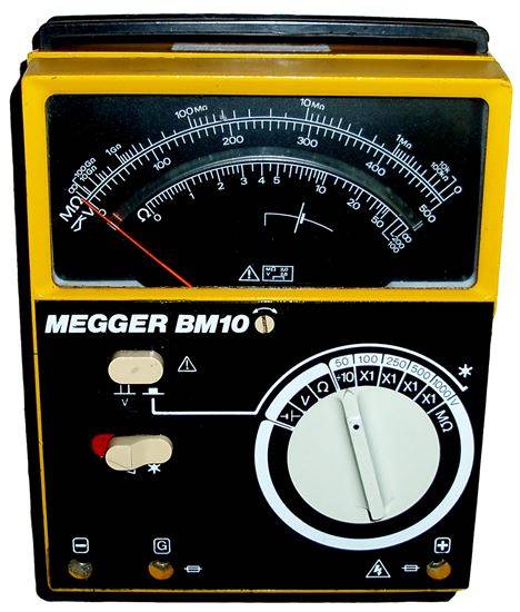

Further to this, I've just bought an old Megger BM10 insulation tester. When it arrives I'll disassemble the alt again and check the stator and rotor windings.

I've never meggered anything in my life! I assume it's best used on isolated windings in motors, generators, transformers, etc. How do you know what voltage to go up to?
Our rule of thumb for industrial machinery was twice rated plus a thousand volts.
On your alternator i wouldn't go above 500 volts, and that much only on a dry day. i think 200 would be plenty adequate if your tester has such a low setting.
Again be careful, meggers are for testing insulation and they'll fry electronics.
Since alternators are capable of around 200 volts on a load dump as you described above,
i'd use that 250 volt setting. Might risk 500 if it's clean and dry.

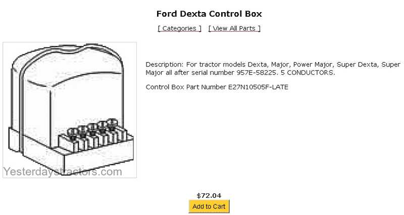

i'd take the top off the regulator and watch the relays operate. Measure at what voltage does the cutout relay close.
Have you a photo of your regulator with top removed?
My brother once had a Triumph roadster with Lucas dynamo*. The regulator looked a lot like this
Line drawing of a Ford Dexta control box with a rounded top cover and a terminal block of five connectors at the front, captioned Ford Dexta Control Box on a parts listing page.
and had inside the standard three coil setup - a voltage regulating coil, a current regulating coil, and a "reverse current cutout" coil.
What you describe sounds like excess resistance in the field circuit. I'd open the regulator and wipe the contacts with either a correct burnishing tool(NOT a file or sandpaper) or some rough Kraft paper as from a brown grocery bag.
Then check condition of the wires from field to regulator and regulator to ground.

Further to this, I stripped the reg out of the tractor, cleaned the contacts (NOT with sandpaper, as I have done all my life but never knew better!) and all is working. I didn't try adjusting anything. I owe you a pint of IPA. Also, I loved the Delco-Remy guide. You don't see such attention to detail in modern manuals - too often the words "refer to authorised service centre" appears.
This is fortunate because, if you're interested, I've got the Megger and have tested the windings of the alternator. The manual shows proper operation but doesn't really go into interpreting the results, so I'd appreciate your input:
RECTIFIER: 1.1 Gohm @ 50V for all diodes in reverse. Didn't dare go further.
ROTOR: Coil resistance, 3 ohm. Coil-case: 200 Mohm @ 50V, 100 Mohm @ 500V. My verdict: PASS.
STATOR: Confirmed delta config. Separated coil wires before test. Labelled coils A, B, C. All coils <0.5 ohm.
A-B: 5 kohm @ 50V, 3 kohm @ 500V.
A-C: 10 kohm and 5 kohm.
B-C: 20 kohm and 9 kohm.
All coils to case: 3.5 Mohm @ 50V, 4 Mohm @ 500V. Not sure why, assume difficulties in reading scale at 50V.
My verdict: FAIL due to inter-coil shorts.
Thoughts? I did test at 1000V afterwards, and the needle jumps to near zero.
That interwinding resistance sounds too low to me, though it probably was functional. I'd expect tens of megohms. Perhaps it was wet or very dirty. One can wash them with soap and distilled water then dry in an oven about 120 degF and sometimes improve the readings a LOT.
After the 1kv test, does it read shorted with plain old ohm-meter?
Anyhow - congratulations on your great adventure inside the Lucas regulator.

I should have mentioned that the readings were taken after washing in soap and (tap) water then drying on top of the stove.
It doesn't read shorted with the multimeter now, but if I squeeze the coils gently the reading will jump around a lot. Remember this is a faulty unit that I haven't found a real fault on until now. I'm guessing when the alternator warms up and is in use the insulation breakdown becomes a problem. Now I need to find some other uses for the Megger unit...
Yup, intermittent coil-to-coil short. Hope you can find a motor rewind or alternator repair shop nearby. It's possible to do it yourself but kinda touchy, and often hard to get the right size wire and insulating paper if used.
