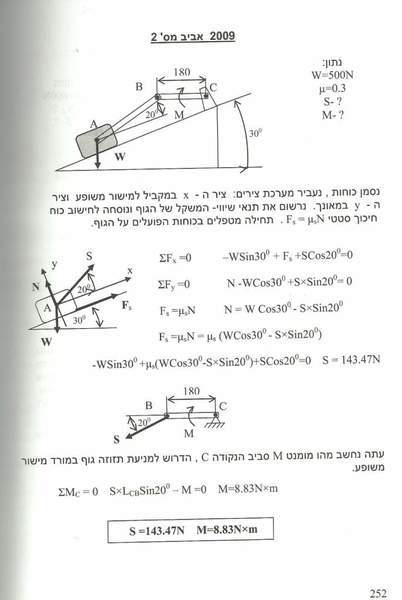

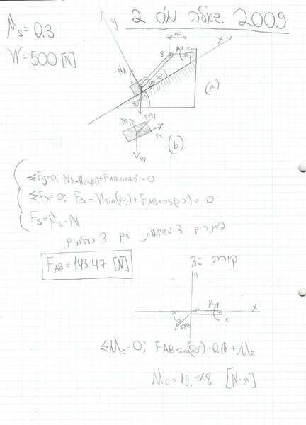

The X axis in the first diagram is in line with the surface, but when you isolate BC it doesn't have to be. Notice how when we isolate BC our angles our different. Who's correct?
http://img192.imageshack.us/img192/236/objectthingy.jpg
The object is in static equilibrium.
Static Coeffecient between the box and surface: 0.3
Weight of box: 500 [N]
Measurements in mm
Joints are smooth pin.
Do the calculations as the box about to descend down the surface
Ignore the weight of lever ACCalculate:
Force at AB
The moment around C, acting on the arm BC
I got Fab correct (in the solution manual they call it "S"). However, we have our differences at beam BC about the angle, which I'd like you to help me resolve. The manual thinks it's 20 degrees, I think it's 50 degrees. Attached my attempt and the solution manual's.

Precisely what angle are you referring to?
Hi FP, :)
I'm afraid the angle of BC is unknown.
It seems to me that the problem statement is incomplete.
What you'd actually would need to do, is define a generic angle phi that BC makes, and calculate the moment as a function of phi, but it seems to me that it's as yet too early to do that.
In the drawing BC seems to be parallel to the ground, making the angle in your calculations correct! :)
The solution manual's "choice" makes BC parallel to the slope.
I'd recommend putting a note in your solution that you have "chosen" to take BC parallel to the ground in order to find a numeric solution.

Really? Are you sure? We're told the surface is 30 degrees from the ground, and that AB is 20 degrees from it. It appears clear to me it's 50 degrees! (20+30)
http://img171.imageshack.us/img171/7159/angle2p.jpg
Hmm, it's drawn and calculated though as though it's parallel to the ground!
But we have different numeric solutions, so someone must be wrong!

Yes, but there might be tiny angle of say 3 degrees and it would throw all your calculations off!
But all the measurements are given to me, that's the exercise. It doesn't say anything about hidden degrees, and I never heard they exist. Have anyone ever seen those 3 degrees? I keep hearing stories about them, but where are they? Frankly I'm a 3 degrees atheist. Call me a sinner!

Wait wait wait, so far in all my calculations of static exercises (and I've solved tons, you've participated in some) I never had that you can get a different numerical result for using a different plane. Fab is the combined vector of its y and x components. But the combined vector must have a certain defined angle from the horizontal plane. Look at the solution manual, it draws a STRAIGHT LINE and still defines it at 20 degrees. But we agreed it's 50! I'm totally baffled.
I give in! :smile:
You are *right*.
The angle is 50 degrees and the solution manual is *wrong*.

Let me put it this way.
It's obvious to me that they made a mistake in the solution manual. They misjudged the angle and thought it was 20 degrees. I give my stamp of approval for saying that.
But if you would make that "mistake" yourself on an exam, I expect you could convince the teacher to allow it^^

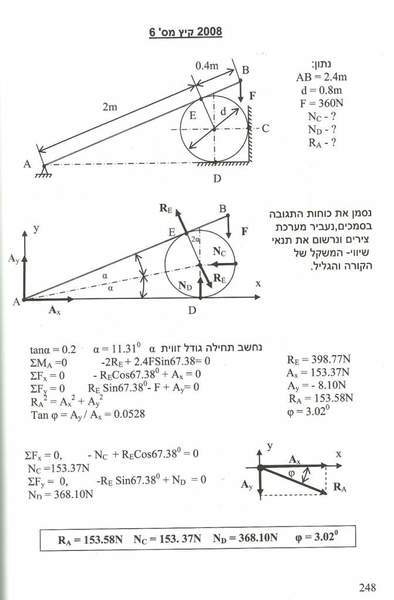

Speaking of tiny wrong angles... my alpha in this question (11.537) IMO is more accurate than the solution manual's alpha (11.31). Can you confirm that?

Sorry, no.
Alpha is part of a triangle where the hypothenusa is as yet unknown.
The fraction of the other 2 sides corresponds to the tangens.
So alpha = arctan(0.2 / 4) which is what the solution manual says (as opposed to your alpha = arcsin(0.2 / 4) which is not true).
In your drawing the right angle on top is drawn like a little bit less than a right angle (just a tiny bit) making it easy to think that the other angle near the center of the sphere is a right angle.
But the hypotenuse is 2! I think.
I didn't do arcsin (0.2/4)
I did arcsin (0.4/2)!
Are you telling me that the hypotenuse is actually the length from A to the center of the circle? Hmm.. I now see in the manual's drawing that it is indeed not 90 degrees angle...
Yes.
My mistake. I mixed the numbers up.
I meant arctan(0.4 / 2) which is arctan(0.2).
