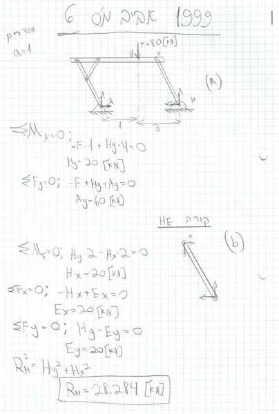

So I got everything right other than Rd (the end). I personally think there's a mistake in the solution manual.
Basically these are all pin joints, even the "hydrolic cylinder" (CD) is weightless and connected by pin joints, so the fact it's called or drawn as "hydrolic cylinder" doesn't matter.
F = 80 [kN]
Ignore the weight of all the beams
http://img198.imageshack.us/img198/3063/sketch1999.jpg
Attached
  • Handwritten statics solution on graph paper for problem 6 (1999): a truss frame with a 80 kN load at top, dimensions 1, 3, 2, and force equilibrium equations giving Hy = 20 kN, Ay = 60 kN, Hx = 20 kN, Ex = 20 kN, Ey = 20 kN, and resultant RH = 28.284 kN.

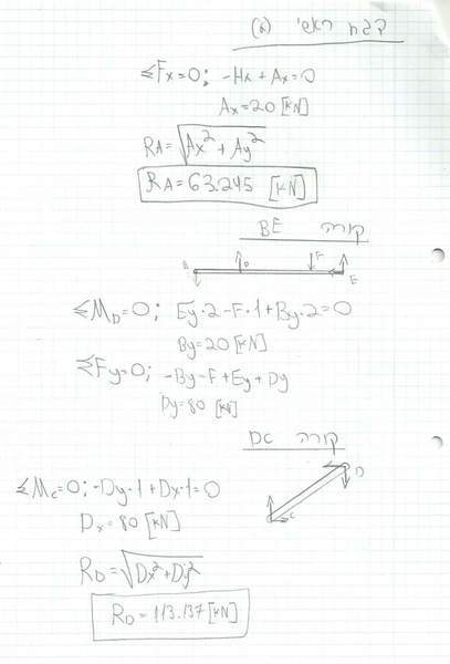

  • Handwritten statics solution on grid paper: sum of Fx = 0 gives Ax = 20 kN, RA = sqrt(Ax^2 + Ay^2) = 63.245 kN; sum of MD = 0 gives By = 20 kN; sum of Fy = 0 gives Dy = 80 kN; sum of MC = 0 gives Dx = 80 kN; RD = sqrt(Dx^2 + Dy^2) = 113.137 kN, with free-body sketches of beams BE and DC.
I can't fault your solution.
I give it my stamp of approval. :)

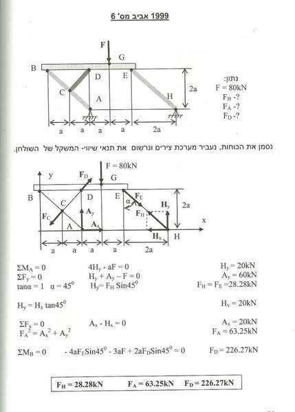

Answer manual's Rd = 226.27 [kN]
Solution manual full solution attached
  • Handwritten solution to a truss statics problem showing the structure with force F = 80kN, labelled joints A to H, dimensions a and 2a, and the reaction equations and final results FH = 28.28kN, FA = 63.25kN, FD = 226.27kN.

Yes, there's indeed a mistake in the solution manual.
They took the force at E in the wrong direction.
They really should have drawn proper free body diagrams as you did! :)

i also believe your work is correct. and it is very clear and easy to follow; nice job.
