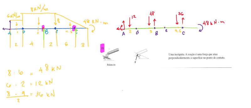

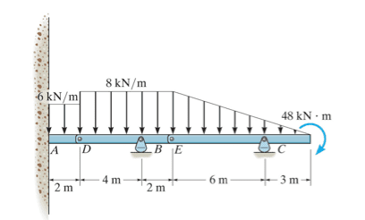

Determine the support reactions at the fixed support at A and the rockers at B and C for the compound beam shown. The beam consists of three members that are pin connected at D and E. Determine the forces at both pins D and E.
Everything is at equilibrium: equilibrium equations.
So far I got the simplified forces of 12, 48 and 36 kN, at 1, 5 and 9.5m (from A) respectively, but I'm confused as what to do next, can you help me?

You can write down a momentum equation and a vertical force equation for each of the mombers. One of these equations will only involve one unknown force or momentum. Solve that and one of the other equations will become easy.
Why 9.5 meters from A?
