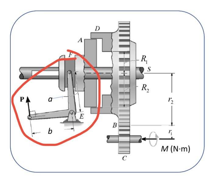

Part of a project I am working on (part #3…see description below) is asking us to find the internal loads (shear and moment) and draw the corresponding shear/moment diagrams of the control arm shown below. It’s a little tricky to me, because all of the members associated with these type of problems are normally straight….this travels along the x and y (it’s bent…)

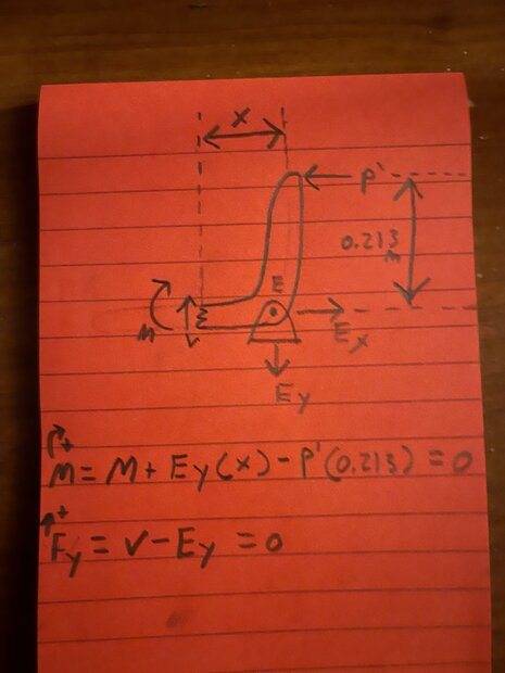

The FBD I drew below shows how I THINK this should be sectioned in order to create the moment and shear diagram, but I’m really not sure. The moments do cancel when you reach the end of that member along the x-axis, so it seems like this should be accurate. Any insight would be beneficial. Thank you!
You can do your analysis like if sections a and b were aligned, there is no difference regarding internal moments and shear loads.
The direction of the reaction force vector at the pivot must consider the directions of forces P and F, though.

Let me ask you this: so if you look at the FBD I drew on the red pad where I made my cut through section A along the x axis…..if I made the shear/moment diagram with that, and then made another FBD but this time, I had the section B along the x-axis and made a second moment diagram for that section, would that be the same thing? I don’t see how it couldn’t be, but I want to see what you think, because that was my initial intent….just make 2 moment diagrams from each “arm” of the control arm.

That would be perfectly fine.
Take a look at the last examples of this link:
https://eng.libretexts.org/Bookshel...ibuted_Load_Shearing_Force_and_Bending_Moment
