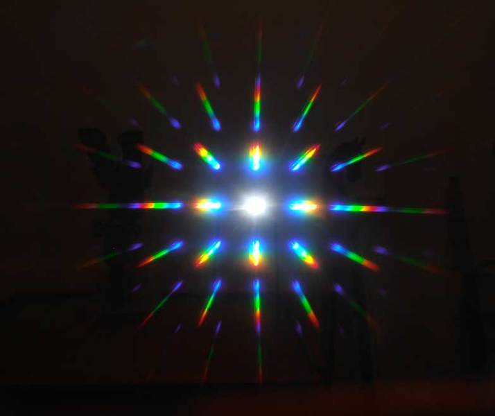

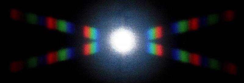

First of all i will post a picture of it ... you can find it ... somewhere
sorry this is my first post :I
I photographed our television with the flash on in order to recreate a strange patter i saw when looking at the suns reflection in the screen.(with my eyes it's not just the camera)
You can clearly see diagonal stripes and the different wavelengths get split into multiple maxima.
Over all it reminds me A LOT of light hitting a diffraction grating, which would make sense since the boundaries between the individual (sub-)pixels are dark and reasonably close together and that would make them behave a lot like a grating.
NOW THE PROBLEM
Why the hell are they DIAGONAL ?
And why are there two STRIPES ?
Usually when light hits a diffraction grating you get a line of bright dots (perpendicular to the slits or absorbant stripes) or in the case of a two dimensional grating you get a grid of dots.
And on another monitor that is exactly what i am observing.
When shining a laser on it i even see 5 dots (the others are too faint to make out) in exactly the way you'd expect (perpendicular lines) when the reflected light is projected on a surface.
My first idea was that the pixels might be arranged in some strange not perpendicular pattern, but they are not :(
Though that you can observe a diffraction pattern at all is a little strange since these dark stripes between the pixels are behind the glass surface off which i thought the light would be reflected.
That might be important ...I would be glad if anyone of you would give this a shot and try to figure out what is going on o:):confused:

Suggestion, can you take another picture with the camera rotated 45 degrees from the last shot. Does the pattern rotate?
This might explain it.
https://jasmcole.com/2016/02/21/tv-diffraction/
From the above,
"Most of the light from the flash is reflected straight back, causing the white region in the centre of the image. However some light is reflected back at an angle, causing it to appear displaced from the centre of the image. Furthermore, red wavelengths are deflected outwards to greater angles, causing the light to be spectrally dispersed in the reflection.
This kind of device is known as a diffraction grating, used extensively in experiments to split a light source up into different frequency components. In this case fine structures in the TV screen are causing the reflected flash light to diffract. The camera lens then maps diffraction angles to positions on the camera CCD."

The picture you posted was very helpful.In that picture you seem to have ALL the things you would expect from a diffraction grating:
Two "rays" perpendicular to each other and two diagonal ones (which are part of the gridyou should see)
Here are some pictures of what a normal 2d diffraction grating will do
http://www.animations.physics.unsw.edu.au/labs/diffraction/diffraction-labs.html
see 3.3 especially the picture
But i think my new question is
If TV screens act as diffraction gratings why are the diagonal maxima SO MUCH more intense than everything else ?
It is like we are only seeing a part of the picture.
How are screens different from usual gratings ?
PS: I think i can explain why the two "rays" in my picture aren't perpenicular:
The pixel densities in both directions are not the same and so the first 8 maxima don't form a nice square but a normal rectangle.

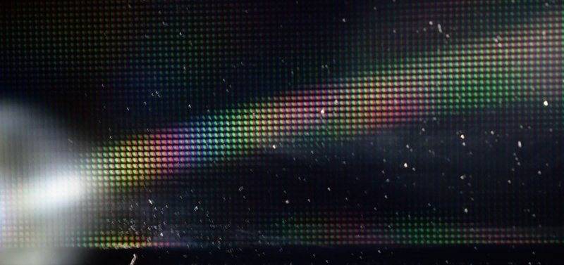

Update:
I really don't think saying "it is just a diffraction grating" is a decent explanation for this.
you can clearly see the dark stripes between the pixels, something that wouldn't happen with a normal grating
And when closely examining the transition from red to green i believe you can see that the dots of light of different color are not on the same grid.(cant tell in the uploaded version/quality to bad)
This offset between the centers of the dots makes me believe that what we are seeing is actually light that penetrated the glass somehow, interacted with the subpixels and then reemerges from the screen.
That would explain why the amounts of cyan and yellow seem to die out in the outer "rainbows".
The light is simply absorbed by the respective subpixels which only let red or green or blue through.
Why the light would come back this way and why it is arranged in this pattern is still a mystery to me :L
I would really appretiate your help :nb)o:)

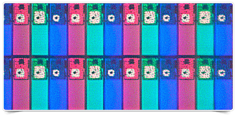

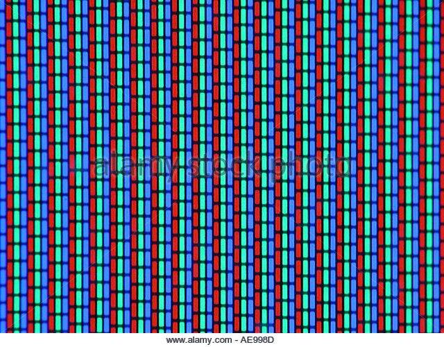

Maybe your TV's pixels are arranged like this. Note how vertical rows are not all lined up horizontally but alternate up and down.
and not this,
Note the slightly different "crystal" patterns. Gives different diffraction patterns?
By changing the ratio of the height to the width ratio of the "primary LCD atom" in the first image above you could change the angles in your photograph?
and not this,
I am somewhat confused by what you mean by "primary LCD atom" and crystal in this context.
Are you referring to the shape of the subpixels, because they resemble crystals ?
And that because they aren't perfect rectangles but "crystal-like" you suggest that might influence the diffraction pattern.
Is that correct ?

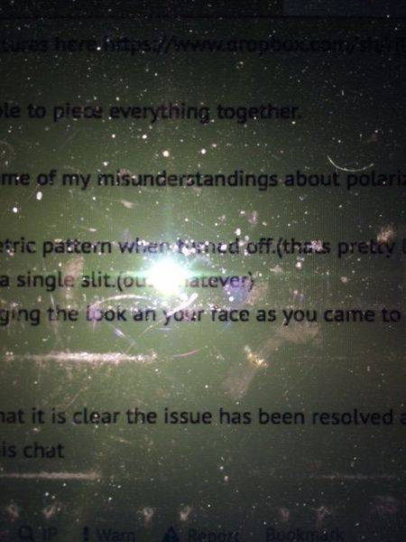

So after forever trying to get my camera to focus of the screen 3 cm in front of me while simultaneously shining a flashlight on it, this is the result :
I got to admit was a little disappointed when i saw they were arranged side by side without any offset.
But then i realized this is by far the best photo we have of this "penomenon".
PS: I was not shining the flashlight on the colourful part, the (out of focus) reflection of the flashlight can be seen in the lower left corner.

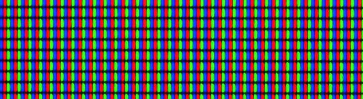

Do you have a magnifying eyepiece? With mine I was able to understand the odd set of diffraction lines on our Panasonic flat screens (plasma I think). With the eyepiece I could focus on the pixels and as I was moving the eyepiece away from the TV and the pixels moved out of focus I saw a square-rectangular grid of thin black lines with approximately the dimensions of the pixels BUT! they were not running north-south, east-west but the grid was rotated from such an arrangement so that the grid ran approximately in the 11-5 and 2-8 o'clock positions.
The image of the alternating basis of pixels I posted I now think was from a old style TV with a cathode ray tube, my theory bits the dust I guess.

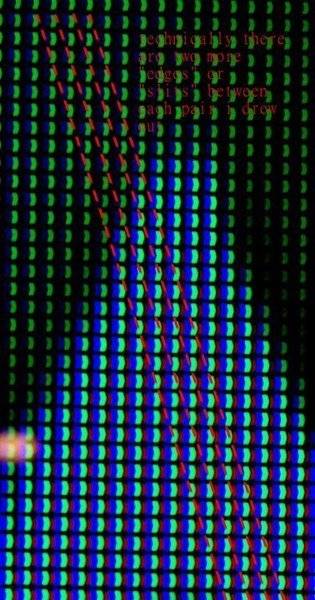

THANK YOU VERY MUCH Spinnor :biggrin::smile:
You solved the mystery.
Your first idea was correct !
It has something to do with the shape of the pixels.
I was actually shocked that the solution was so simple.(somewhat underwhelming)
In the first TV screen each pixel is made of two parallelograms at an angle.The boundaries of these ARE perpendicular to the "diffraction line".
And in the second TV screen something similar happens except that the "crystal" (as you called it) upper and lower ends of the pixels form the patterns.
Although i find it a little weird that such a discontinuous pattern can create regular old diffraction like
a set of continuous lines.

A grid would show much more pronounced maxima, and it would not show the pixel structure.You don't see the dirt under regular light conditions:
I am going to try to convince you that it mostly behaves like a grating.Ok ? :)
It does show pronounced maxima.At least the screens in my/our household.
As proof i would have you take a look at the "diffuse laser long exposure" (the name was something like that) picture.
The reason you see multiple dots where you would just exect one maxima
is that i moved the laser around a bit (during the long exposure) by accident and these are the same maxima in the pattern.
Just made by differently postitioned light sources.
That the maxima are still a little diffuse is likely due to the "diffraction grating" having huge holes.
See this
I tried to draw in the "pixel boundaries"
I know it is quite the opposite of well made °~°.
So it doesn't really act like a grating but it is the model that comes closest.
Actually the part that acts as a grating in the screen form the "laser long exposure" is even patchier.
To further proove that it behaves like a grid i photographed the reflection of the laser after being reflected of the screens.(projected on a surface)
I put them in the dropboxfolder.https://www.dropbox.com/sh/rjlerz83qaelhuq/AACQ5ew_S7AYFLfO5ZFscA0Ea?dl=0
They all have Laser in the name.

I know the pattern in your photo looks a lot like a single slit
but think about it ... wouldn't the frequencies get separated more ?
I think the grating maxima are incredibly close together.
and because the maxima of different colours and different "diffraction orders" overlap the whole thing looks pretty white.
Additionally in every grating you can still see some single slit effects:
http://physics-animations.com/Physics/English/photo/images/797420.jpgI hope i could convince you :D
Let me know if i did :wink:
Actually in the laser long exposure picture there is a strange horizontal pattern that
looks like it was made by either either a single slit or just a few slits.
So i might be wrong after all :eek:

If we would see a grid diffraction pattern, the pixels could not be visible at all. You cannot have interference between adjacent pixels if they are resolved in the image.
Tazerfish said:
The slits themself don't cast any shadow ...
You see light if two conditions are satisfied: (a) the direction is right for light coming from the pixel (it is a camera/eye observing the pattern) and (b) the angle is right for positive interference.
The last picture is not from an extended grating, it looks like a double-slit or maybe triple-slit pattern. Otherwise the maxima would be much smaller and sharper.

The reflection of the Laser does have extremely pronounced maxima.(take another look at the pictures)
It couldn't have been produced by a single slit or double slit.
I trust the observations that much.
I think we agree on that right ?

I can see up to about the sixth maximum.
That has been confirmed by an experiment with a laser pointer.(disclaimer i did actually shine the laser in my face with a one of the "other maxima"o0)
but my eyes are all good the laser is only p<5mW)
