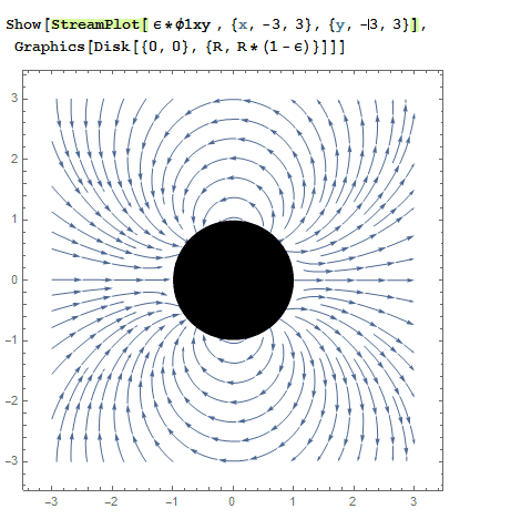

Ok, doing that brings me to $$ \Phi_1(r,\theta)=\frac{v_0}{2}\left[ 3\frac{R^2}{r}\cos\theta - \frac{R^4}{r^3}\cos(3\theta) \right].$$
Plotting the vector field $${v}'=-\varepsilon \nabla \Phi_1$$ leaves me with this awesome yet unexpected picture.
Luckily, my potential is ##\Phi =\Phi_ 0 +\varepsilon \Phi_1## and since ##\varepsilon \ll 1## the vector field for ##\varepsilon =0.01## looks much better:
Thanky you bigtime, pasmith. I think this is it. I learned a lot.
