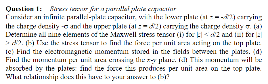

Given infinitely large capacitors both with charge density sigma and minus sigma use the stress tensor to find the force on each.
None needed
The question is partially taken from Griffith's book. I am confused about the physical meaning of momentum in fields. I have determined the solution and found that in part d the momentum crossing the x-y plane is some value in the positive z direction. I don't however understand the physical interpretation of that. Does that mean that field transfer momentum upwards towards the positive plate? Does the momentum get absorbed by the capacitor? But then wouldn't it be going upwards? That of course makes no sense because the plates are oppositely charged and therefore they should attract.

It can be a nightmare keeping track of signs and directions. Griffiths explains that the quantity ##\left( - T_{ij}\right)## can be interpreted as “the momentum in the ##i## direction crossing a surface oriented in the ##j## direction, per unit area, per unit time".
(a) Consider ##\left(-T_{zz} \right)##. How would you interpret what this quantity means when evaluated at a point on the x-y plane?
(b) Can you express ##\left(-T_{zz} \right)## in terms of the electric field strength between the plates?
(c) Is ##\left(-T_{zz} \right)## positive or negative for points on the x-y plane?
(d) In which direction is z-component of momentum flowing across the x-y plane?
(e) Is the region above the x-y plane gaining or losing z-component of momentum? What about the region below the x-y plane?
Don't feel like you need to answer all of these questions at one time. We can take them one at a time.

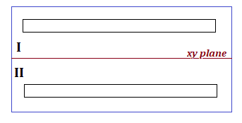

Let region I enclose the upper plate and region II enclose the lower plate. Which region is gaining z-component of momentum and which region is losing z-component of momentum?
TSny said:
Yes. So, z-component of momentum is flowing across the xy plane in the downward direction.
Region II is gaining z-component of momentum and region I is losing z-component of momentum
Yes.
Suppose the two capacitor plates are released from rest with no external forces acting on the system. The only interaction between the plates is the electromagnetic interaction due to the charges they carry. As time progresses, region II increases its z-component of momentum. This means that the lower capacitor plate gains z-component of momentum. Thus, you can deduce which way the lower plate will start to move. Apply the same reasoning to deduce the direction that the upper plate moves.
TSny said:
Yes.
Okay that is starting to make more sense now. Just need to clarify a few small things. There is no magnetic field in the question. Therefore the Poynting vector is zero everywhere. So the volume integral of our Poynting vector will be zero. Therefore the electromagnetic momentum at any point in space should be 0. How then can there be a flow of electromagnetic momentum if there is 0 electromagnetic momentum between the two plates.
Yes
The Poynting vector is associated with the momentum stored in the electromagnetic field. Griffiths denotes this field momentum as ##\mathbf p_{\rm em} ##. If you take any volume ##V## of space, the field momentum in this volume is $$\mathbf p_{\rm em} = \mu_0 \epsilon_0 \int_V\mathbf S d\tau$$ where ##\mathbf S## is the Poynting vector. If there are material particles within ##V##, then there can also be momentum due to the motion of the particles. Griffiths refers to this momentum as "mechanical" momentum ##\mathbf p_{\rm mech}##.
The key theorem relating these two types of momenta and the stress tensor ##\mathbf T## is $$\frac{d}{dt} \left(\mathbf p_{\rm mech} + \mathbf p_{\rm em} \right) = \oint_S \mathbf T\cdot d\mathbf a$$ This says that you can get the rate of change of the total momentum inside ##V## by integrating the stress tensor over the surface S that bounds the volume. So, the stress tensor represents a "flow" or "transport" of total momentum across the surface S.
As you noted, for the capacitor ##\mathbf p_{\rm em} = 0##. So, we just have $$\frac{d \mathbf p_{\rm mech}}{dt} = \oint_S \mathbf T\cdot d\mathbf a$$ If the surface S encloses one of the plates, then ##\mathbf p_{\rm mech} = m \mathbf v## where ##m## is the mass of the plate and ##\mathbf v## is the velocity of the plate.
