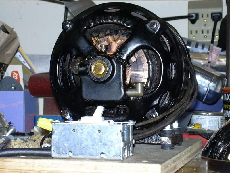

Many years ago, before World War I, there were single-phase fractional-horsepower induction motors called repulsion-start motors, that had low-resistance eddy-current coils on the armature which were shorted by brushes on a commutator for high starting torque. The starting torque was superior to the modern capacitor-start induction motor, and had lower starting surge currents. But they were expensive motors to build, and were phased out as capacitors became cheaper. See attached photo of the radial commutator in a fractional HP induction motor (circa 1915).

Bob what I think you are referring to is a repulsion-start induction-run motor right? These started as a universal motor (series I believe) and when up to speed a centifugal switch shorted out the commutator so the armature 'appeared' the same way the rotor in a more modern induction motor 'appears'. Unless you are referring to something different? There are motors like this around that are much newer than WW1.

Yes, the motor I pictured is repulsion start, induction run.
The centrifugal switch on the motor pictured retracts the shorting (grounded) brushes on the radial commutator to disconnect the repulsion start when the motor approaches full speed.. The squirrel cage on the rotor are always connected. It is not an AC/DC (universal motor) that has powered windings on the armature. Century Electric I think stopped making repulsion-start motors about WWI, but other brands did continue into the Depression (and maybe until WW II). I happen to have a depression-era Delta Mfg. Co bandsaw that belonged to my granfather that has a monster 1/2 HP repulsion start motor.
