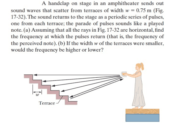

My problem is the theory I am unsure how any equations apply to this problem. This seems bad that I have no attempt at solution but I am honestly unsure how to start or of any relevant equations.

Think instead of looking after equations. Imagine, you stand at distance d from a wall, and you clap once. The sound reflects from the wall. What time after the clap does the echo reach you?

v=dt
so t = v/2d
OmniNewton said:
v=dt
so t = v/2d
You mean the time is the shorter the longer is the distance ?
What is the correct answer?
And what is the time if the wall is at distance d+w?
What is the difference of times if one wall is at distance d and the other wall is w distance farther?

Sorry about the delay I've been really thinking this through. I'm just unsure what is being said by difference of times.
The first of your problem is how do you get the time you need to cover a distance d with speed v. You travel with speed 100 km/h, what time is needed to reach a town at 200 km distance?

2 hours
What is the general formula used to get time from distance and speed?

d=vt
t = d/v

It is correct now. In what time does the echo of the clap return from a wall at distance d? And what is the time of return from a wall at distance d+w?
The time taken to return back(when the distance is d)
is equal to 2d/v where v is the velocity of sound
and when the distance is d+w
The time taken is 2(d+w)/v
Therefore
The difference in the times taken equals 2w/v

Alright after looking at Uchiha's work that is correct. difference in time represents the period.
So,
f = 1/T = v/2w = 343 m/s/2(0.75m) = 230 Hz
for b) since f is proportional to 1 /w the frequency will be higher
