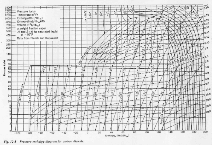

Now, these results are all derived assuming that the CO2 vapor in the final state at 25 C (77 F) behaves like an ideal gas. But that is not really the case. Here is a Pressure-Enthalpy diagram for CO2 which clearly indicates that the behavior is not ideal.
So, how do you think that this changes things?

The pressure-enthalpy graph I presented provides sufficient information to quantify the difference in the internal energy changes. But, certainly, the final internal energies ##U_{1f}(T, P_1)## and ##U_{2f}(T,P_2)## are not equal if CO2 is non-ideal. So, assuming the two systems start in the same state, the change in internal energy for the two processes will be different.
Even like this, however, we would need the volume of the container for the first process, in order to compare both processes.
You are expected to assume that two initial volumes, pressures, and temperatures are the same in the two cases.
If you would like to perform a quantitative calculation using the pressure-enthalpy diagram I presented, I can show you how to do it.
