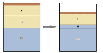

A container has its bottom half filled with water and the top half filled with steam, both of which are at 100 degrees celsius. The surroundings are kept at 100 degrees celsius and heat can flow through the walls of the container.
If a massless piston at the top of the container is slowly pushed down so that the volume of steam is halved, what is the net heat added to the system?
Ideal gas equations, P-V Work
I've worked out that half of the steam must condense (since the pressure of the steam needs to remain constant for the forces on the massless piston to balance). Also, if the total volume of the container is ##V##, the work done on the system equals ##\frac{P_{atm}V}{4}##. When half of the steam condenses, the heat released to the system is ##Q_{1} = \frac{m_{steam}l}{2}##. Since I don't know what the heat exchanged between the container and surroundings is, I'll call this extra contribution ##Q_{2}##.
From the first law, ##\Delta U = Q_{T} + W = \frac{m_{steam}l}{2} + Q_{2} + \frac{P_{atm}V}{4}##.
In the solutions, the final line is to set ##\Delta U = 0##. From this, if we were to substitute in numerical values, we could find out ##Q_{2}##.
I don't, however, understand why ##\Delta U = 0##. I know that if the system contained only gas, the internal energy depends only on ##n_{gas}## and ##T## so at constant temperature ##\Delta U## is necessarily zero. I believe it is similar for incompressible liquids, that internal energy only depends on ##V_{liquid}## and ##T## (i.e. if we have more liquid at the same temperature, the internal energy has to be greater). However, in this system we have some liquid and some gas, and the relative amounts are also changing.
So why does the condition that ##\Delta U = 0## still hold?

It helps me to have a picture:
Part I is the initial part of the vapor that doesn't condense in the process.
Part II is the vapor that does condense
Part III is the initial water
During the process, II is converted from vapor to water.
I take my system to be I+II+III. The first law applied to the system is
##\Delta U_{sys} = Q_{sys} + W_{sys}## [Eq. 1]
Here, ##Q_{sys}## is the net heat transfer between the system and the environment and represents the quantity asked for in the problem.
Now, parts I and III do not change their internal energy during the process. So, ##\Delta U_{sys} = \Delta U_{II}##.
Also, I believe that ##W_{sys} = -P\Delta V_{sys} = -P \Delta V_{II} = W_{II}##. So, ##W_{sys} = W_{II}##. Thus, Eq. 1 becomes
##\Delta U_{II} = Q_{sys} + W_{II}## [Eq. 2]
or
## Q_{sys} = \Delta U_{II} - W_{II} ## [Eq. 3]
By the first law, the right side represents the heat gained by II during the process. But we know that the amount of heat gained by II equals ##-m_{\small II}l##. (The minus sign is because II loses the "latent heat" as it condenses.)
So, ##Q_{sys} = -m_{\small II}l = -\frac{m_s l}{2}##, where ##m_s## is the original mass of steam in the container.

Your reasoning seems very airtight, and after a little more thought it does seem intuitively that ##-ml## should be the change in heat of the system (if the container and surroundings are both at the same temperature/in thermal equilibrium, why should any heat transfer between them apart from the latent heat from within the system?).
The difficulty in this question seems to be in careful definition of the system/subsystems.
It finally became fairly intuitive to me also, but it took quite a while for me to get there.
Yes. If you take just parts I and III as "the system", then it's easy to see that ##\Delta U = 0## and ##W = 0## for this system. Hence, also, ##Q = 0## for this system via the first law. That means that all of the heat lost by part II (i.e., ##ml##) must show up as heat transferred to the environment outside the container.
