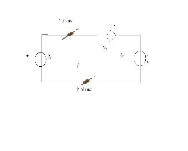

In the picture u can see there are two voltage sources, I am confused one how to apply KVL to this. the book has this problem worked out and they get -12+4i+2v-4+6i=0 but i don't get this , i get this -12+4i+2v-4v-6i=0 and solutions isn't the same, what is my problem? For some reason there getting +6i and I am getting -6i. WHy does this happen. Can someone please explain clearly, how to solve something like this, and for future circuits ?

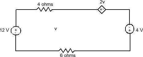

I uploaded the circuit again, please explain me why its +6i not -6i, and how do two batteries act on a circuit like this

I can't see your second image yet, so assuming it's the same.
I suggest you actually draw current arrows around the loop.
Yes, even though it is a single loop.
Without the rest of the circuit.
If you have two batteries +(12)-+(4)-, how do they act?

Hi th3plan! :smile:
ok, I can see the first picture now.
It shows three voltages sources (two "facing" one way, and one the other way), and two resistors, all in series.
(btw, why couldn't you have said that? :wink:)
The book multiplies the current, i, by the two resistances, 4 and 6, and adds them: 4i + 6i.
You want to subtract them: 4i - 6i. Why??
The resistances themselves are neutral, and the current, i, is flowing the same way, since, as you pointed out earlier, there's only one loop.
(that's why i assumed there were two loops …*it's the only way to get both i and -i)
You just treat them like any other potential difference, in any loop in KVL 2 … if the potential differences are "facing" opposite ways, then of course you subtract them. :smile:
