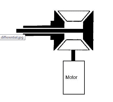

I cannot imagine a single mechanism that'd produce opposing rotations, everything I've seen employs gears of some sort. There's even a PF thread on the subject,
https://www.physicsforums.com/threads/coaxial-rotors-with-one-motor.909579/ .
This image from that thread shows one mechanical solution.

I think in your shoes i'd contact these folks and explain your need is bigger than hobby but smaller than general aviation.
https://www.contraelectric.com/innovation/the-system-components
Probably an engineer there will know who serves that market niche.
If this is for a one of a kind test bed, and you have a creative machinist partner on the project,
i'd peruse the marine salvage yards looking for the lower unit from an outboard motor so equipped. Maybe you'd get lucky and find one with a blown powerhead for cheap.
