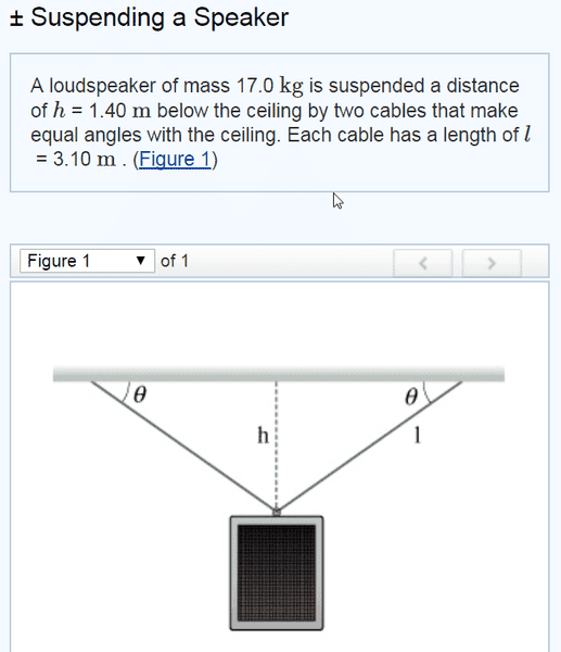

1. The problem statement, all variables, and given/known data
Assuming standard coordinates, Net forces in the x plane are 0, by
I have worked out that
[tex]\arcsin { \left( \frac { 1.4 }{ 3.1 } \right) } =\quad 26.8{ 5 }°\\ loud\quad speaker\quad =\quad wg\quad =\quad 166.77\quad N\\ 2T\sin { \left( 26.8{ 5 }° \right) \quad =\quad 166.77 } N\\ T\quad =\quad 84.2824[/tex]

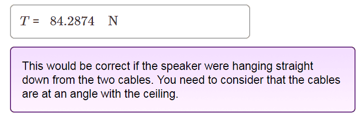

Masteringphysics returning with an incorrect solution response and is giving me this piece of information.
I do not understand what this error implies.
I have tried;
[tex]\\ T\sin { \left( 26.8{ 5 }° \right) \quad =\quad 166.77 } N\\ \\ \\ T\sin { \left( \frac { 1 }{ 2 } 26.8{ 5 }° \right) \quad =\quad 166.77 } N\\ \\ T2\sin { \left( 26.8{ 5 }° \right) \quad =\quad \frac { 166.77\quad N }{ 2 } }[/tex]

Radians v. degrees.
Sorry, can you expand a bit more? I understand the difference but not in the context of this question.
pemby said:
sin(26.85°)
What value did you get for that?
0.438371146789077417452734540658265739062755719988552114431
Then I do not see how you could have got that final answer. You had
pemby said:
2Tsin(26.85°)=166.77N
Maybe you halved twice?
Thanks. it was reading my degrees as radians. I tricked my self by not double checking!

Btw, you can often avoid figuring out the angle. In the present case, you wanted sin(θ), which is h/l, so the accurate answer is 17g*3.1/(2*1.4).
