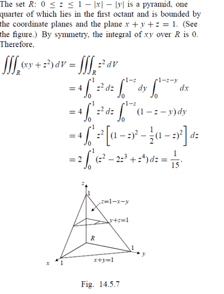

Why is it symmetrical thus zero?
The original equation is with main focus on the first part, cause therein lies the symmetry
[tex]\int\int\int xy \quad dV + \int\int\int z^2 \quad dV[/tex]
and
[tex]0 \leq z\leq 1 - x - y[/tex]
See also the picture!
I drew a drawing in the xy-plane and it was a line with equation [tex]y = 1-x[/tex].
So that allowed me to set up the triple integral as:
[tex]\int_{0}^{1}\int_{0}^{1-x}\int_{0}^{1-x-y} xy \quad dzdydx = \frac{1}{120}[/tex]

Durdum said:
I tried calculate it hundreds of times
Could you please post your steps in detail for one of those, so we can help you ?
Can you show us the triple integral for the xy term and how you evaluated it?
It would have been useful to write the problem statement here.
Durdum said:
integrals with boundries {x, 0,1}, {y,0,1-x}, {z, 0, 1-x-y} dzdydx
If you integrate it over 1/4 of the set only, it is not zero. Integrate it over the full set (not what the image shows) and you should get zero.

Yes, I plotted [tex]z = 1- x - y[/tex] in Wolframalpha and I saw that the shape was symmetrical, BUT the domain is for [tex]z\geq 0.[/tex] So I don't understand why it is okay. If you would say that the front in the picture is 1/4 and the back is 1/4 so a total of 1/2, then I understand but again the book wants you to calculate for z above 0, zo why multiply with 4 and not 2?
I can figure that it is an odd function because [tex]f(-x) = -f(x)[/tex] but the calculation does not add up.
NOTE: I used wolframalpa to be sure that I don't mess up the algebra, so I make a mistake however I don't understand where!
The integral you have calculated is correct, giving ##\frac 1 {120}##. But the ##xy## domain for your pyramid looks like this:
You have only done the integral of ##xy## over the shaded portion. If you do the remaining three regions you will find that you get the same ##\frac 1 {120}## for quadrant III and ##-\frac 1 {120}## in quadrants II and IV, so the total integral is ##0##. It is because of the signs of ##x## and ##y## in the various quadrants.

Yes! I understand, however I only drew the first line and not the other three. Why and how could I have distilled that from the equation?
[tex]z = 1- x - y[/tex], with [tex]z = 0[/tex] in xy-plane gives [tex]y = 1- x[/tex]
The equation you were given was ##0 \le z \le 1 - |x| - |y|##, and that right side is ##1-x-y## only in the first ##xy## quadrant where both ##x## and ##y## are positive. The equation ##1 - |x| - |y| = 0## gives the diamond shape in the ##xy## plane.

So that was my mistake! I was working on my problem for hours and couldn't find out what the problem was because I thought I did it right. The problem are the absolute values, I thought that meant it belonged in the first orthant only. However when I plotted the equation in wolframalpha.com with the absolute values I saw that it is a 4 sides pyramid.
