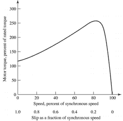

Babadag said:
Higher slip higher force.
As the load is increasing the required force increases and then the slip increases.
Well, yes, with some limitations. Typical torque characteristic for an asynchronous motor:
Thank you, Hesch.I agree with you of course.:smile:
