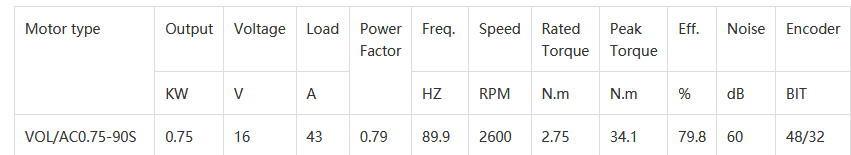

Meanwhile i tried to decode the motor parameters from the following link volcano motors
Variable speed AC motors
From the above table i understand the O/p power is = 0.75KW. There is no mention of KVA, why? How do i calculate? Is it KVA = 16*43 KVA = 688KVA
I/p power = V*I * Power factor = 16*43 * 0.79 = 543 W = 0.543 KW. I observe the input power is less than the output power of 0.75KW, why?
The other calculation of o/p power is = Torque * Speed (rad/s) = 2.75 * 2600*2 * PI/60 = 748W = 0.748KW. This is matching.
Efficiency = Output / Input , the output is greater than the input, the efficiency is greater than 100%, how is it possible? What is the mistake.
Power factor is another way to express the same thing, avoiding the need to deal with KVA or VARs.
Good for you for spotting an erroneous >1 efficiency. We either have a misinterpretation, or an error.
My guess is an error by whoever made that nameplate. They might have started with V and P and multiplied by .79 to calculate A where they should have divided. If so, then the amp draw could be 59 A rather than 43. 16*59 * 0.79 = 746.
The output power is correct using the formula P = Torque * Speed = ##2.75 * 2600*2 * \pi/60 = 748W = 0.748KW.## The efficiency as per the table is 79.8. Hence the input power should be
efficiency= ##748*100/\text{Input power} = 79.8 ##
Input power = ##748*100/79.8 = 937.3 KW##. If i assume the current calculation is wrong then the current is
##V*I*\cos\theta = 937.3 ##
##I = \frac{937.3} {16*0.79} = 74.15 A##

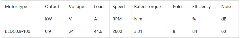

I verified another table in the same link Volcano motors for the permanent magnet brushless motor
I/p power = 24*44.6 = 1070.4 KW
O/p Power = 2600*3.31*2*PI/60 = 0.9KW
Efficiency = 900*100/1070 = 84% and it matches with the values specified in the table. But my major confusion is there is no power factor mentioned or KVA. Generally any motor contains the inductor and resistance, so why the information is not mentioned?
