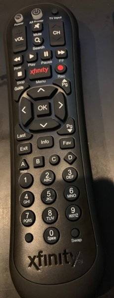

Jackie1
Black Xfinity remote control with a power button, TV input, volume and channel rocker keys, transport controls, a directional pad with OK, and a numeric keypad with Swap key.
Open battery compartment of an Xfinity XR2 remote showing two AA-R6 batteries with spring contacts, with a black screw boss visible in the centre, beside a laptop keyboard edge.

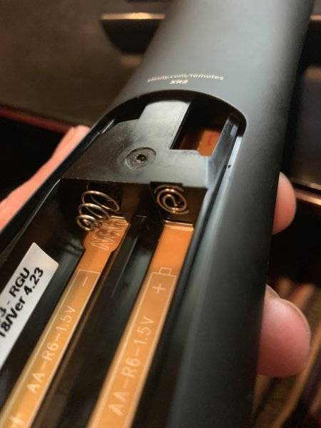

I want to take apart a comcast remote. Even after I take the batteries out, there are no screws under the battery cover like on older remotes to take them apart.

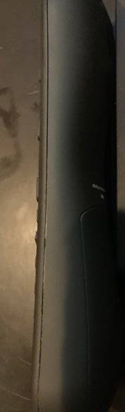

Close-up side view of a dark grey remote control showing the thin seam between its two halves, with a small printed logo near the lower right edge.
- Super small seam here around the remote is so thin, a typical splunger tool you can use to take a cell phone apart won't work, as tool still too thick.

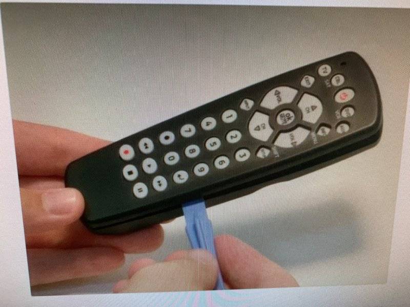

Below is a generic remote I found tear down instructions for, but seam on above remote is much thinner to use this.
Dark grey TV remote held in a hand, with a thin blue plastic pry tool inserted into the seam along its lower edge.
Any ideas?

Any bit of plastic that's thin and of the shape in the picture would do. I have used a round edged table knife. The secret is to see the tab you have to push in by looking carefully into the joint then pushing and twisting at the same time. Once a tab has been released it may stay out but there may be six tabs and one or two may slip back. Patience, Keep at it and be as gentle as possible.
BTW, why do you want to take it apart? Has it stopped working or are you just curious? The 'keys/buttons' are probably all on one moulded sheet and they can sometimes accumulate moisture underneath. Wiping with a tissue can sometimes restore function - temporarily.

Thank you. THis remote is just super super thin, where even a knife is too wide to fit into the crack.
I'm taking part to paint the top portion of the remote, WHITE. The tv is white, and in a all white kitchen, and I'm helping someone out who's very fussy and wants a white remote like the tv came with (but you can't use that one as it's on comcast, where you need to use their remote, which is black) :)
You might find that a set of "feeler-gauges" (typically used for automotive spark gap setting) will help. They come in a set of varying thicknesses, have nice rounded ends, and are fairly robust. The clamshell is no doubt held together by snap-fit tabs (as per @sophiecentaur) and you'll have to either eyeball them or otherwise determine their location by how the shells respond to torques applied as you move around the slot.
In your 2nd photo showing the empty battery compartment, what is that round thingy just above the two battery spots? Is it a rivet?
There's a chance that the remote is ultrasonically welded, so to take it apart you have to use a hacksaw to get the joint separation started. And/or decapitate that rivet... Have you considered just painting it by hand? And what are you going to do with the white lettering on the black plastic top body?
Not sure what it is. It’s plastic. I saw the link posted above to the metal splunger tool but I still think that’s too wide to fit in this gap also the gap is hardly even recess so I think anything I put in the side is just going to make the plastic fold over. These remotes are free and it’s ok if I ruin one but I can’t even figure out where to begin. Maybe a dremel in one corner and then try to pry after making a thin cut?
Not sure if it’s ultrasonic welded but maybe.
And the paint, it’s no big deal if it covers the lettering as those buttons are self-explanatory and no big deal to cover them since the button indicates what they do.

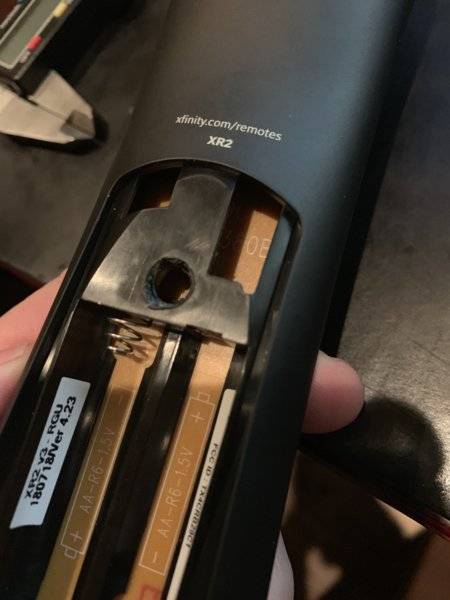

Open battery compartment of a black Logitech XR2 remote showing two R6 1.5V AA batteries with their spring contacts, and a small screw in the compartment's inner plate.
  • Open battery compartment of a black Logitech XR2 remote showing two R6 1.5V AA batteries with their spring contacts, and a small screw in the compartment's inner plate.
If that's the case I'd go all neanderthal on one and drill out that potential plastic rivet. I that yields no immediate results then proceed to dremel the slot. Find out how it's held together. Then plot a more delicate strategy for the next one.

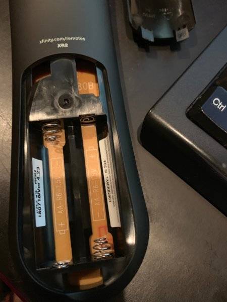

Photo of the back of a remote control with its battery compartment cover removed, showing two AA battery contacts marked AA-R6-1.5V and a central screw hole, with the text xfinity.com/remotes XR2 printed above.
Ok drilling that out did nothing. Hmm. Put it in microwave for 5 min? Lol

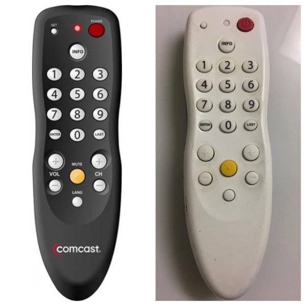

Here’s the old remote I was able to take apart and paint. Which was easy. Not this new one!
Side-by-side photos of two TV remote controls: a black Comcast remote on the left with a numeric keypad, INFO, ENTER, LAST, volume, channel, MUTE and LANG buttons; a painted white remote on the right with a similar layout and a yellow central button.

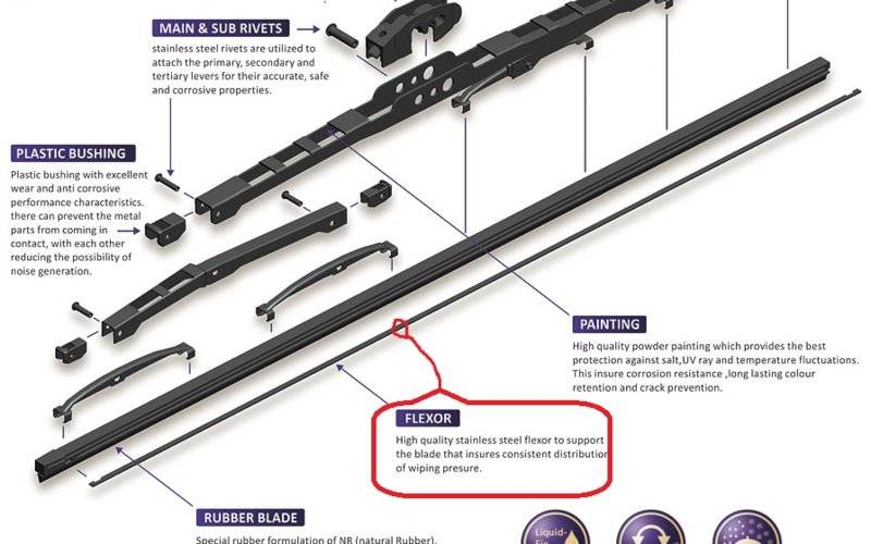

Hint for your toolbox
a handy little pick for such adventures is readily fashioned from a windshield wiper blade flexor and a short piece of ½ inch wood dowel
every auto parts store has old wiper blades in the trashcan by the door
and the little stainless steel flexor in them is really handy for fabricating little tools
just grab it with a plier and yank it out
Exploded diagram of a windshield wiper blade with labelled parts: main and sub rivets, plastic bushing, painting, flexor and rubber blade.
drill a hole longway through the dowel, insert the flexor and glue in place - i like epoxy
then sand the dowel to a comfortable taper
cut and shape ends of flexor with a file
it's good quality stainless spring steel that you can work cold with a file and stout plier
you'll want several with various shaped ends
For your TV remote job, sharpen an end and pry that skinny joint wide enough for a "spudger"
sorry for the digression
just i can't stand it when some plastic contraption makes a monkey out of me...

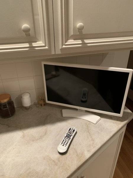

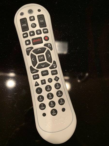

Ok well, wanted to say thanks again to everyone. This forum has been great for those questions no one else would have the answers to. So I did the hammer trick. Used a thin pointed knife and pounded it in the sides and kept prying it apart and finally got it off. The thing was clipped in about 8 places!
Painted it white and now just got to figure where to put the glue. I don’t have silicone rubber but so have “household goop” and e6000 which prob will work. It stay flexible after it dries.

Small white flat-screen monitor with a dark screen on a curved white stand, on a light marble countertop beneath white cabinets, with a white remote control lying in front of it.
  • Small white flat-screen monitor with a dark screen on a curved white stand, on a light marble countertop beneath white cabinets, with a white remote control lying in front of it.

Yea I impressed myself as I didn’t think the knife would do it but it did. It’s barely undectectable from the sides too, looks factory still. The glue is needed though as they won’t snap back on. I ended up doing two.
might consider hot glue , the low temperature variety
so you could take it apart again.
