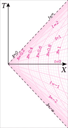

Imagine we have a very tall vertical cylinder like a very elongated telegraph pole, that is rotating at 200 rpm about its long axis on near perfect bearings. Initially the cylinder is sufficiently far from a black hole, that differences in gravitational time dilation between the top and bottom of the cylinder are negligible for our purposes. Let us say there is observer that is stationary with respect to the black hole and located at the bottom of the cylinder. The cylinder is slowly lowered past this observer so that the top of cylinder becomes adjacent to this observer and lower part is very close to the black hole event horizon. Does anyone agree that the observer will see the part of the cylinder that is local to him, slow down significantly, (say by about 90%) and that it will speed back up to 200 rpm when the cylinder is raised again? Will an observer that accompanies the lower part of the cylinder always see that part rotate at approximately 200 rpm? If so, what does this say about conservation of angular momentum?
P.S. Assume the cylinder is sufficiently rigid that it does not get twisted into knots by differences in speed between the top and bottom and that the lowering process is sufficiently slow for the rotation speeds to even out along the length of the cylinder.

Let's see how this looks in the flat spacetime case I described above. Suppose we have an observer who, at some instant of his proper time, is co-located with the lower disk, but whose proper acceleration is slightly greater than that of the lower disk, so he is slowly moving "up" the rod from the lower disk to the upper disk. (We'll assume that we can make this observer's velocity relative to the disks constant; we're not really concerned with this observer's exact acceleration or velocity profile.) What will this observer see?
By hypothesis, both disks have the same angular velocity as seen by observers comoving with either disk (and the rod connecting them is experiencing a torsional stress, as above). But that does not mean that an observer comoving with the upper disk will see both disks spinning with the *same* angular velocity as an observer comoving with the lower disk; that can't be, since their rates of time flow differ. The lower disk observer should see both disks (and the rod) spinning with a *larger* angular velocity than the upper disk observer. Therefore, the third observer, who moves with a constant speed from the lower disk to the upper disk, should see the angular velocity of both disks (and the rod) relative to him *decrease*.
There are still some differences between this scenario and the curved spacetime scenario, so I'm not fully convinced that the argument I just gave carries over. See below.

Nice idea to use acceleration in flat spacetime to try and analyse this. Thanks. I think we are in broad agreement that the static observer will probably see a local slow down of the cylinder as it is lowered past him. I think we also agree that if local observers at the top and bottom of the cylinder see the same local rotational rate then the cylinder will be under significant torsional stress and something has to give. I would now like to introduce a 3rd scenario that might clarify one aspect of the topic.
Scenario 3:
In this variation, the rotating cylinder is held at a constant distance from the black hole. The bottom of the cylinder is driven by a motor that keep the bottom part of the cylinder rotating at a constant 200 rpm as measured locally. The top of the cylinder is free to rotate in very efficient bearings and is "rigidly" connected to the bottom of the cylinder. Assuming the gravitational time dilation factor is ten times greater at the bottom of the cylinder than at the top, will the observer local to the top of the cylinder see the top part rotating at 20 rpm as measured locally and will the top observer also observe the bottom of the cylinder to be rotating at 20 rpm?
Strictly speaking, my flat spacetime analysis doesn't show that. What it shows is that, if we have a cylinder "hovering" at constant altitude, an observer who slowly moves up the cylinder will see its angular velocity, relative to him, decrease.
I understand that you feel a strong intuitive "tug" towards extending that conclusion to cover the case where the observer is "hovering" at constant altitude and the cylinder is slowly being lowered past him. But I'm not sure that intuition is valid, for the reasons I gave at the end of post #13.
I googled for "Born rigid motion" and discovered the Herglotz-Noether theorem which implies that in special relativity the centre of mass of a Born-rigid rotating object can move only inertially.
So in GR in regions where tidal forces are negligible you couldn't have a rigid rotating object held at a constant altitude, it could only be in free-fall to avoid distortion. Presumably tidal forces could make things worse rather than better.

Oy--evidently I was right when I said gut instinct isn't a reliable guide here. :wink:
I found this paper by Giulini which discusses the theorem towards the end:
http://arxiv.org/abs/0802.4345
The key result is his Theorem 18, which he labels as "Noether & Herglotz, part 1", and which says that any rotational rigid motion, i.e., any rigid motion with nonzero vorticity, must be a Killing motion, i.e., every point within the object must be following an orbit of a Killing vector field. Just to quickly summarize my understanding of what this means:
A rigidly rotating object whose center of mass moves inertially satisfies the condition. The KVF is (in the global inertial frame where the object's CoM is at rest) ##\partial_t + \omega \partial_{\phi}##, where ##\omega## is the (constant) angular velocity. This is a KVF since it is a linear combination with constant coefficients of ##\partial_t## and ##\partial_{\phi}##, both of which are KVFs.
A linearly accelerating object which is *not* rotating also satisfies the condition. The KVF here is (in a global inertial frame) ##cosh ( a \tau ) \partial_t + sinh ( a \tau ) \partial_x##, where ##a## is the (constant) acceleration and ##\tau## is the proper time of the accelerating object. This is not manifestly a KVF in the coordinates given, but one can see that it is by plugging into Killing's equation, or, alternatively, by transforming to Rindler coordinates, where the KVF is just ##\partial_T## (##T## is the Rindler coordinate time), and the metric is independent of ##T## so ##\partial_T## is manifestly a KVF. (I've often seen this KVF called the "boost" KVF.)
However, a linearly accelerating object which is also rotating can't satisfy the condition, because the worldlines of each of its points would be orbits of a vector field which, at best, would be a linear combination of KVFs (some mixture of the "boost" KVF with ##\partial_{\phi}##) with *non* constant coefficients. Such a vector field is not a KVF.
I'm still cogitating over how to visualize this physically, but one thing strikes me: another implication of the theorem is the observation (originally due to Ehrenfest, as the paper notes) that a disk (whose CoM is here assumed to be moving inertially) cannot be rigidly *spun up* from non-rotating to rotating motion. (Mathematically, this is because the disk's points, again, can't be following orbits of a KVF, since at best the worldlines would be orbits of a linear combination of ##\partial_t## and ##\partial_{\phi}## with non-constant coefficients.) The physical manifestation of this is that the spatial geometry of the rotating disk is flat (i.e., Euclidean), while the "spatial geometry" (there are caveats to this usage, which is why I put it in quotes) of the rotating disk is curved (i.e., non-Euclidean).
It might be that linearly accelerating a rotating object would act on it, physically, much as "spinning up" a non-rotating object does: it would be like constantly trying to induce a "change in geometry" in the object. Another way of looking at this might be to consider the reason why the "spatial geometry" of the rotating disk has to be carefully defined: there is no global notion of simultaneity shared by all points on the rotating disk. There can't be, since they are all in relative motion. A linearly accelerated object that is not rotating *can* have a globally shared notion of simultaneity (the one embodied in Rindler coordinates); but points at different "heights" along the object will experience different rates of time flow (i.e., different rates of change of their proper time relative to Rindler coordinate time, which defines the common simultaneity convention). The theorem seems to be saying, basically, that you can't mix these two things (lack of global simultaneity and differences in the rate of time flow due to acceleration) and still have a rigid motion.

So basically, for our purposes here, we cannot take a previously Born rigidly rotating object in SR and then uniformly accelerate it in some direction while maintaining Born rigidity of the rotation? And this is because as per the theorem cited, any motion that is a Born rigid rotation must be a killing motion, whereas supposedly a motion combining a previous Born rigid rotation and uniform acceleration could not be a killing motion hence won't result in another Born rigid rotation?
Also, since ##\mathcal{L}_{u}h_{ab} = 2\sigma_{ab} + \frac{2}{3}\theta h_{ab}##, and any Born rigid motion is defined as ##\mathcal{L}_{u}h_{ab} = 0##, this implies the motion is Born rigid iff ##\sigma_{ab} = \theta = 0## where ##\sigma_{ab},\theta## are the shear and expansion of the congruence respectively. Is there a way to visualize the failure of a motion combining both Born rigid rotation and uniform acceleration to itself be a Born rigid rotation in terms of the presence of shear and/or expansion (in SR that is)?
Translating this over to GR, if we consider any extended object in Schwarzschild space-time formed by a fluid with non-vanishing vorticity such that each fluid particle remains at a constant altitude (so that the entire object is at constant altitude), the fluid would have to have a non-vanishing expansion and/or shear so as to fail to have Born rigid rotation?

More precisely, *something* about the motion must fail to be Born rigid. The theorem, as I read it, doesn't specify that the rotation is what has to fail to be rigid; it could be that the linear acceleration fails to be rigid. Or it could be a combination of both.

Suppose we have a flywheel that remains on the accelerating worldline at x=0.4 in the Rindler chart below and another that remains at x=1.0 and we adjust the rotation speeds of these flywheels so that all the accelerating observers agree they are rotating at the same speed as each (although they will disagree on what that speed is). Once adjusted and assuming perfect bearings there is no reason for the flywheels to slow down or speed up as long as they held at constant altitude. I think you will agree that the dimensions or mutual orientations of the flywheels as measured by the observers on the flywheels will remain constant for all time. Does that not satisfy the requirements of rigidity? Now if we connect the two flywheels by a rod, we have an approximation of the cylinder in the OP when initially stationary in a gravitational field.
This seems to contradict the conclusion that we cannot have a "rigid rotating object held at a constant altitude". However, I guess it depends on whether by Born rigid rotation we really mean Born rigid angular acceleration and exclude the trivial case of constant angular velocity.
