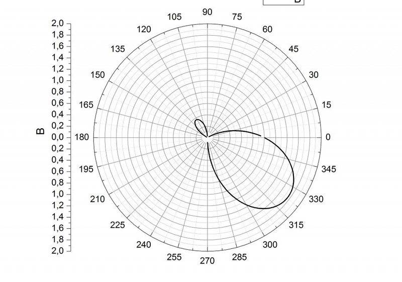

Try to draw the curve r=f(θ). Is θ=pi/4 in the domain?
  • Polar plot in black on a grid of concentric circles and radial lines, angles labelled in degrees and radial axis labelled B from 0 to 2.0; the curve has a small loop near 165 to 180 degrees and a larger loop sweeping from 0 to about 315 degrees.

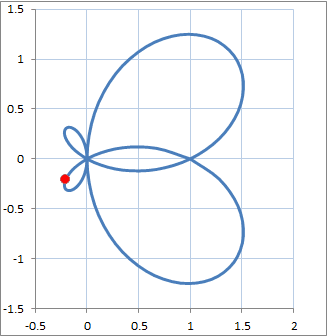

[EDIT]Typo. I see what you mean -- and what the exercise composer means
Blue polar curve on x-y axes from -0.5 to 2 and -1.5 to 1.5, with a self-intersecting loop pattern and a red dot near (-0.2, -0.2).

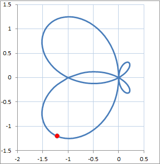

  • Graph of a polar curve on x and y axes from -2 to 0.5 and -1.5 to 1.5, with a closed loop shape having several petals and a red dot marking one point on the lower left petal.
The polar coordinate r can not be negative as it is the distance from the origin.Half of your curve resulted from negative r=f(θ). The problem maker forgot about that.
