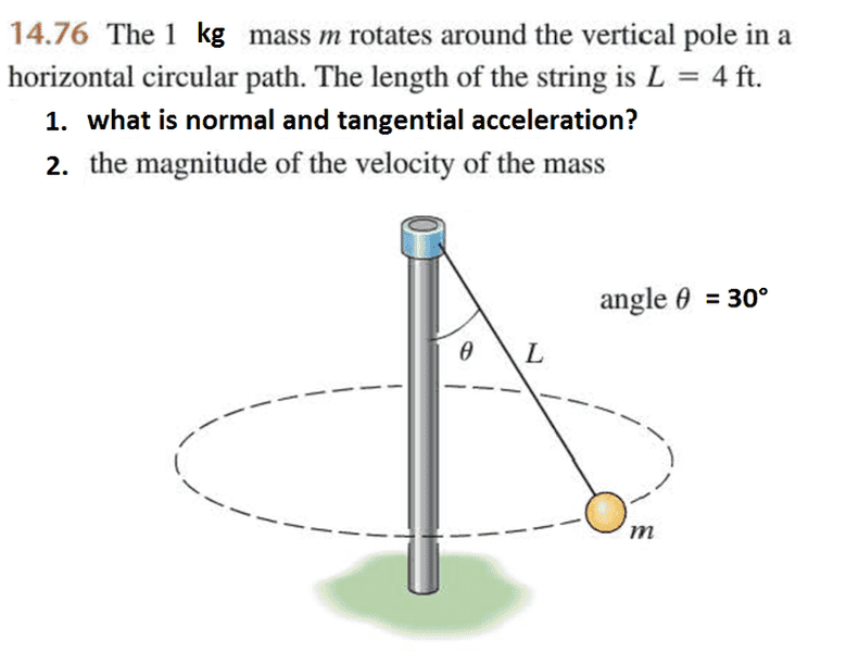

Tangential and Normal of a rotating mass

at = Rα
an = V2/ R = Rω2
Vt
Vn =0
I found at=0
an=5.66 m/s
vt=3.364
vn=0
So v = vt = 3.364 m/s[/B]
Correct?

an=5.66 m/s
If you correct the units, yes.
nysnacc said:
vt=3.364
Please show how you got that.
oh yes, a in m/s^2 typo :)
for vt, first, I need ω, which is found from an = v^2/R where R is L sinθ
SO, v = sqrt (an*R) = sqrt (5.66*4sin30°) = 3.36 m/s
What are the units associated with that 4 (highlighted in red)?
4 in meter, which is the length of L
the question is modified, it was shown 4 ft but actually it should be in meter.

Ah. It would have been nice to have been made aware of this detail in the problem statement o_O
In that case your tangential velocity looks okay.
Likes nysnacc
Hopefully I wouldn't make the same mistake next time, thanks for pointing out :)
And at = 0 (rotating in constant angular speed), vn = 0 (constant radius R) correct?
Yes.
