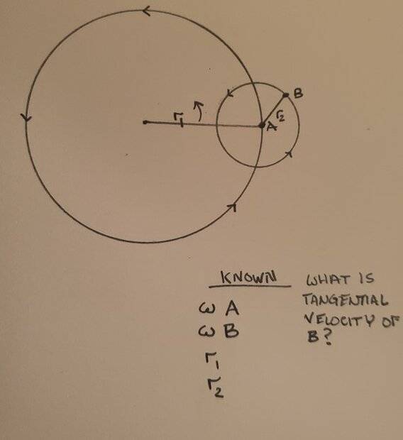

Can the tangential velocity of B be found from the information given?
Welcome to PF.
Yes.
I assume, tangential to a circle about the origin ?
The position of point B is the sum of the two rotating vectors.
The angle between the origin and B changes with time.
The rate of change of that angle is the angular velocity = tangential velocity.
Not quite. Additional needed information is the position of points A and B at time ##t=0##. Then one can find the velocity of B at any later time ##t##.
Do you mean the position in terms of a point on the circle as a degree, like 90°?
Yes. It could be an "o'clock" position for each of the points A and B. In the picture you posted A is at 3:00 and B is at about 1:30, but it doesn't have to be that.

So does the body B already have the linear velocity of body A's? I'm assuming that it must, right? But it's not as simple as adding the two linear velocities together is it?
Ok, then can we solve this using 3 and 1:30?
Here are some arbitrary values:
A ω=.5 radians/sec
B ω = 2 radians/sec
r1 = 10m
r2 = 3m
v = r*ω
Would I calculate each linear velocity to start with?
Try to do this using symbols, not numbers. It will be easier for us to check your work. Use LaTeX for writing equations. If you don't know how, click on the link "LaTeX Guide", lower left above "Attach fiiles."
Let the angular velocities be ##\omega_A## and ##\omega_B## and the positions be ##r_{\!A}## and ##r_{\!B}.##
Yes, but to do that you first need to find ##r_{\!A}## and ##r_{\!B}## as functions of time.

Please tell me why B will start rotating?
The OP diagram shows B rotating about A, while A rotates about the origin.
Because ##\omega_B## is assumed to be non zero.
I will do my best.
kuruman said:
to do that you first need to find r_{\!A} and r_{\!B} as functions of time.
Ok, I'm not sure how to find that. I thought r is a function of length.
##r## is the length of a position vector from a fixed origin. Look at your drawing. Both ##r_1## and ##r_2## depend on time as point A goes around the large circle whose center is fixed and point B goes around the smaller center whose center is point A and not fixed.

I wouldn't expect anything less than that. Please post it so that we can help you move along. Begin by finding the tangential velocity of point A.

Using the numbers I posted:
vt = ω r
vt = .5 x 10 = 5 m/s
Velocity is a vector and has both magnitude and direction. The magnitude (also known as speed) is constant but its direction changes depending on the time you look at it. How can you express the velocity as a function of time? Hint: Write the position of point A as a function of time and take the time derivative.

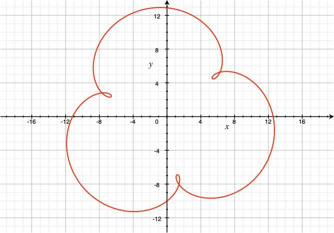

If you insist. So let's forget about vectors and use a drawing. Shown below is the trajectory of point B using your numbers and assuming that A starts at the 3 o' clock position and B at the 2 o'clock position. The velocity of point B is tangent to the trajectory at the point of your choice.

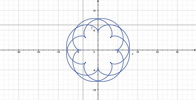

But will you be able to solve the general problem? Shown below is a trajectory with everything the same except that ##\omega_B##=11 rad/s. Could be a piece of jewelry.
