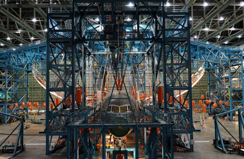

I'm also curious about "expired" carbon fiber. Carbon fiber is not like tomatoes. Boeing has 12 year old 787s out there, and that carbon fiber is no youger than the plane. P can more easily believe "we thought we would use fiber type X but we switched to Y" or even "this is what's leftover on the spool when we wind a fuselage". At least more than going stale.

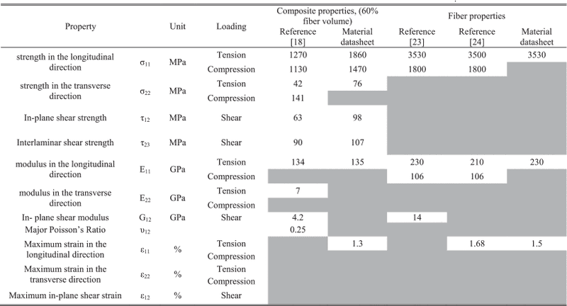

Here's an interesting article from 2017, Composites World magazine.
https://www.compositesworld.com/articles/composite-submersibles-under-pressure-in-deep-deep-waters
The magazine goes into details of the OceanGate "Cyclops 2" submersible, it isn't clear whether this is the Titan vessel.
The rationale for the carbon fiber design is identified:
OceanGate CEO Stockton Rush says the company had been evaluating the potential of using a carbon fiber composite hull since 2010, primarily because it permits creation of a pressure vessel that is naturally buoyant and, therefore, would enable OceanGate to forgo the use — and the significant expense — of syntactic foam on its exterior.
There's info in the article that makes me question the "out of date" CF and the 7 vs. 5 inch stories.
Spencer opted for a layup strategy that combines alternating placement of prepreg carbon fiber/epoxy unidirectional fabrics in the axial direction, with wet winding of carbon fiber/epoxy in the hoop direction, for a total of 480 plies. The carbon fiber is standard-modulus Grafil 37-800 (30K tow), supplied by Mitsubishi Chemical Carbon Fiber & Composites Inc. (Irvine, CA, US). Prepreg was supplied by Irvine-based Newport Composites, now part of Mitsubishi Chemical Carbon Fiber & Composites Inc. The wet-winding epoxy is Epon Resin 682 from Hexion Inc. (Columbus, OH, US). The curing agent is Lindride LS-81K frLindau Chemicals Inc.cals (Columbia, SC, US).
Initial design work indicated that the hull, to be rated for 4,000m depth with a 2.25 safety factor, should be 114 mm thick or 4.5 inches, which OceanGate opted to round up to 5 inches (127 mm) to build in an additional safety margin.

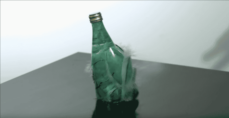

Consider something like a plastic drinking straw failing in excessive suction/external pressure, with the result that it is no longer round - it is compressed to a flat strip with only open parts at the edges of the strip where the bending rigidity stops it from folding against itself? It is elastic deformation (remove suction and the straw reopens), but do you have another term for it besides "collapse"?
