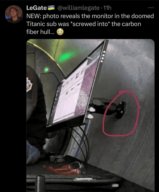

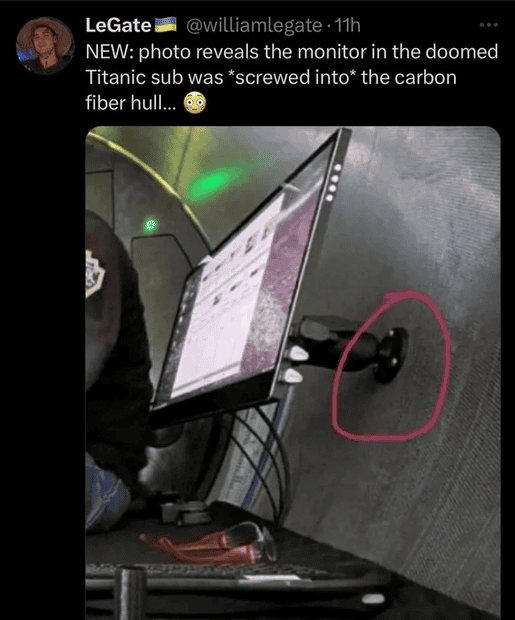

Saw some interesting speculation on instagram (I know I know) that this is analogous to the 1996 Mt Everest disaster (of Krakauer “Into Thin Air” fame), in that it may actually boost deep sea tourism. The argument for Mt Everest was that until these rinky dink companies popped up, you had to be a legitimate mountaineer to climb Everest. But after the disaster, rich folks realized they could just pay a company to drag them up the mountain. Essentially, the disaster was an advertisement for the existence of these “adventure” companies, and indeed, Everest tourism has subsequently skyrocketed, with often long waiting lines to get to the summit (of up to two hours! Seriously, people have complained of their oxygen tanks running out while they’re waiting in line to get to the Everest summit like it’s Space Mountain). Some folks are wondering if this is the same moment for deep-sea tourism.
Also, yeah the fact that carbon and titanium are at opposite ends of the galvanic series and you’re tossing the thing in saltwater raises some eyebrows. But at least according to Wikipedia, OceanFateOceanGate had made a dozen or so excursions to this depth, which is comparable to the number of crewed Dragon SpaceX missions.

Vanadium 50 said:
...where you most want a measurement is usually where something else is - a bolt, a rib, a penetration...
... a mounting screw or three... 🤔

pinball1970 said:
That's real?
Dunno.
But the crewmember
  • is sitting on a flat floor with no equipment nearby, and
  • has a mission patch that seems to check out.
