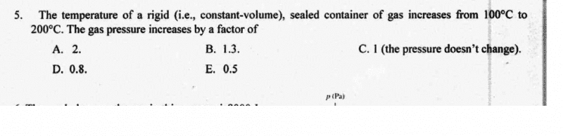

Temperature change with gasses.
4 replies · 1K views
littlejon
pv=nRT
Celsius and kelvin read the same so that means the pressure does not change because the gasses volume does not. C
Show more work.
y = x
therefore
y = 2x?
100 ceclius = 373k 200 celecius = 473k
473/373 = 1.3
Ok, now what happens when you divide PV from state B by PV from state A? what's the ratio?
473/373 = 1.3
This result is correct.
