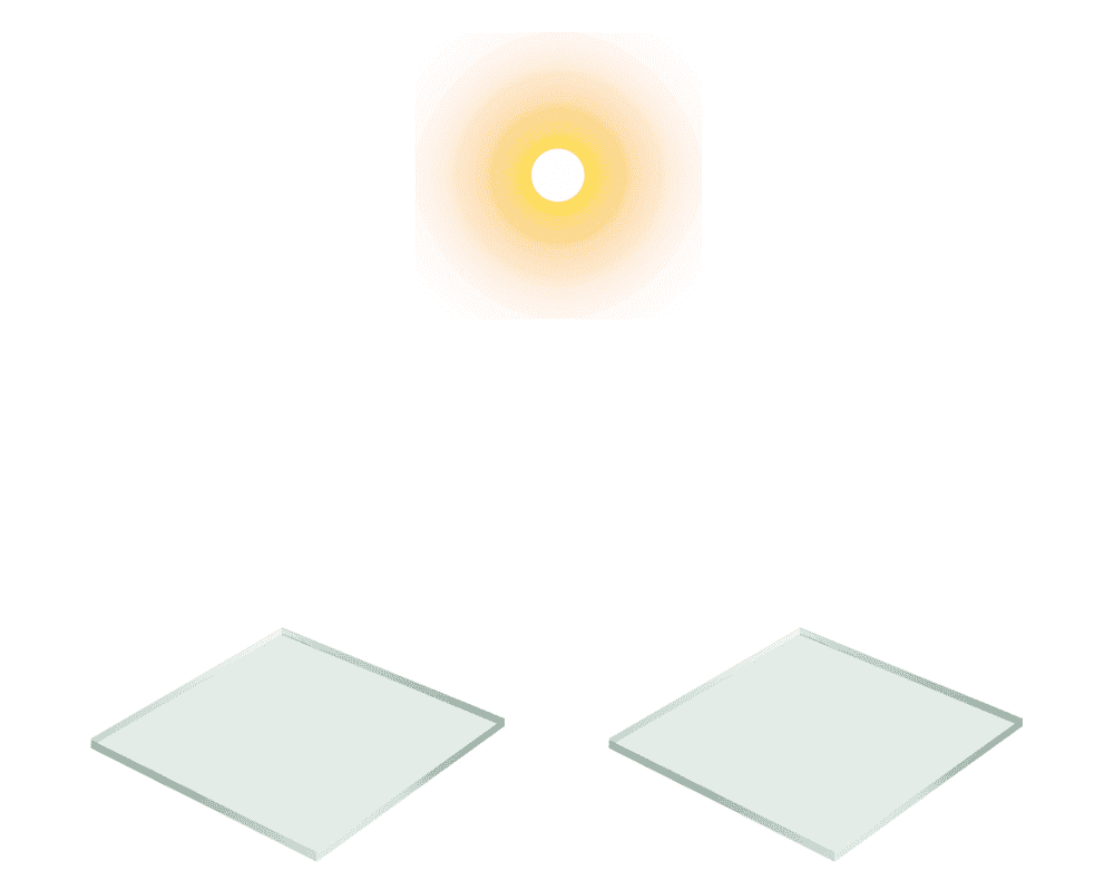

Consider two 1 square meter marble slabs each of mass 1 kg floating in space facing the sun such that light from the sun incident perpendicularly on the flat faces.
Diagram of two flat square slabs floating in space below a glowing sun, shown in isometric view and facing the sun.
At equilibrium, power received from the sun 'PS' equals the power being lost in the form of radiation 'PR'.
PS = PR (at equilibrium)
For simplicity, assume the equilibrium temperature TE = 300K.

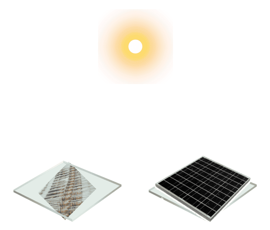

Let us now install a photovoltaic solar panel on the right slab and resistive load on the left slab.
Assume the mass of the photovoltaic panel and resistive load be 1 kg each.
Connect the panel and load using wires and a switch of negligible mass.
Diagram of two flat square slabs in space under a sun, one with a diagonal marble-like texture and one with a black photovoltaic solar panel grid.
Let the new equilibrium temperature also be 300 K.
At time t = 0, the pv cell is connected to the load by closing the switch. Let the power being transmitted from pv slab to load slab be 'PPV' and all this power is consumed by the load slab.
So the net power received by load slab is PS + PPV and the net power received by pv slab is PS - PPV.
Since PS + PPV > PS - PPV,
So what happens to the temperature of the slabs?

I think that the power consumed at the load converts into heat and so the temperature of load slab increases.
Coming to pv slab, net power received is reduced due to diversion of some solar power to load power and so the temperature of pv slab decreases.
Am I correct?
Am I correct?
Yup!

Because this is an intermediate level post I would like, for completeness, to include one complication.. The slab is made of marble which is presumably not very absorbtive (or therefore emissive). Panting (only) the sunward side of the slab black would increase its radiative equilibrium temperature. The solar cells are black and not 100% efficient and so the true answer is unknown because of these competing factors.
But the rest of the analysis is fine.
