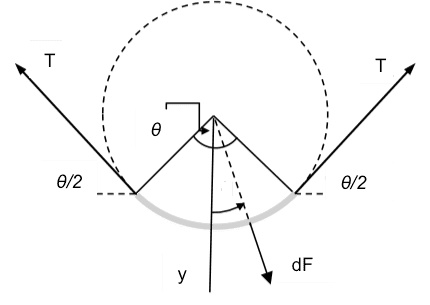

@haruspex , @kuruman If the current flows in anticlockwise direction (instead of clockwise as in the OP ) and magnetic field is perpendicular to the plane of the page , the direction of force on any infinitesimal portion of the wire will be radially inwards .
Would the force on this tiny element from the neighbouring wire element be exactly opposite to the one shown in post#11 ?
But this force doesn't look like some tension force . Is it some type of compressive force ?
But magnitude of this force will still be BIR just as in the OP .Right ?
@haruspex ,please reply this .Is the direction of force from the neighbouring elements exactly opposite to the one shown in the diagram in post#11 ?
Yes, it will be opposite. If ##d\vec F = I d\vec l \times \vec B##, then ## I d (-\vec l) \times \vec B = -d \vec F##.
I am not asking about the direction of force on the tiny wire element by the magnetic field :smile:
I am asking about the direction of force on the infinitesimal length element from the neighbouring elements . Just like in post#11 you showed the two forces by ##T## .
My question is that if an anticlockwise current flows then the direction of force would be exactly opposite to the one showed by two ##T##'s in post#11 ?
The tensions will change direction, if that's what you are thinking. The endpoints of the circuit are assumed fixed so that one can analyze the forces. When the current changes direction, the magnetic force will change direction and you will have the same force diagram as in post #11 except that will be reflected 180o about the horizontal axis passing through the endpoints (dashed line in post ##11). In other words, the tensions will reverse their perpendicular components to the dashed line, but not their parallel components. In the end, the entire loop will still be under tension except "upside down" in a sense.
I believe @Jahnavi has it correct. If ## \vec{B} ## is upward and ## I ## is counterclockwise the force points outward from each part of the loop. ## \\ ## If the current is clockwise the force from each part of the loop will be of a compressive form, and it will be towards the center of the loop for each part of the loop.

kuruman said:
Perhaps I wasn't very clear with this statement. The entire diagram will be reflected. This means that the arc under consideration will curve down instead of up.
I feel this diagram is same as the one in post#11 .
Please see this .
Don't you think if the current is in anticlockwise direction , direction of force due to neighbouring current wire element will be as shown by the red vectors ?
